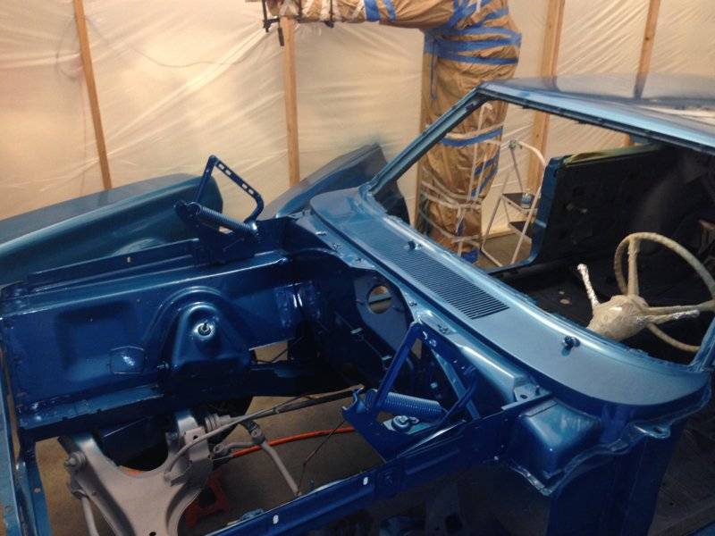

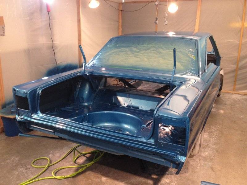

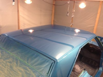

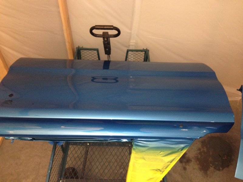

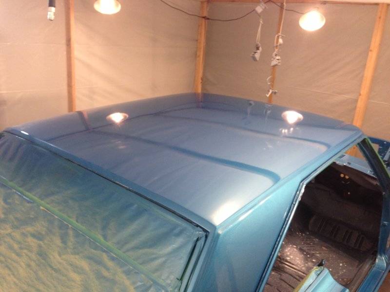

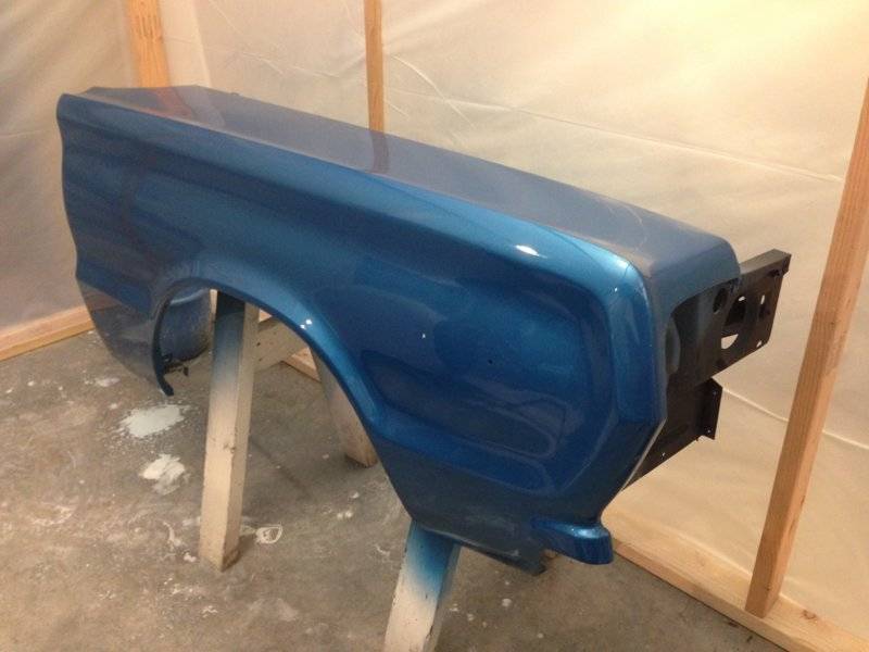

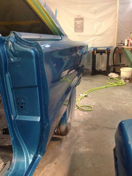

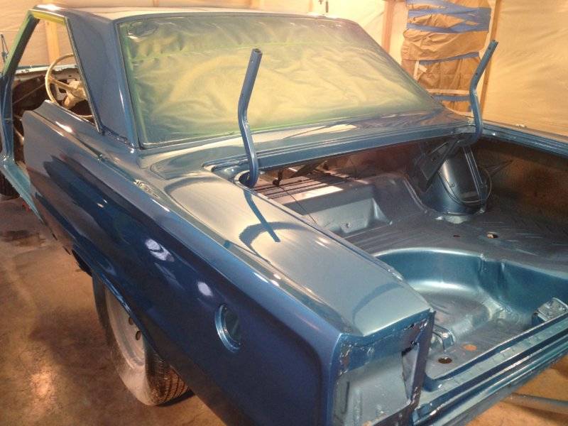

A few pictures,
IMG_0157.JPG IMG_0156.JPG IMG_0152.JPG IMG_0131.JPG IMG_0134.JPG IMG_0160.JPG IMG_0146.JPG
In my eyes this paint seems to change color under different lighting.
Sunlight makes it look a lighter Blue.
Indoors, or in shaded areas it can seem a very deep Blue
or a different Blue altogether. IMO
And, I like it a lot!

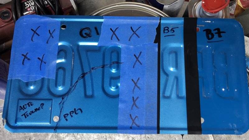

That is correct. When spraying metallic paints not only do gun settings, but viscosity of the paint, solvent speed, temperature, and the painters technique can make the same paint appear different. If the metallics settle in the wet paint, the paint appears darker. If the metallics do not settle, they paint would appear lighter as they reflect more light.
I ran this route already. Here is the spray out for QQ1, B5, and B7. I agree, QQ1 changes color with sun and shade, seems crazy.
