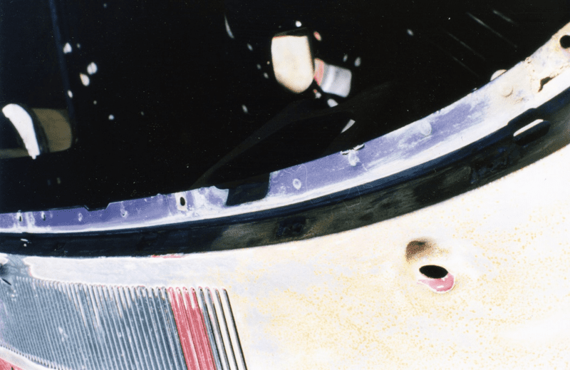

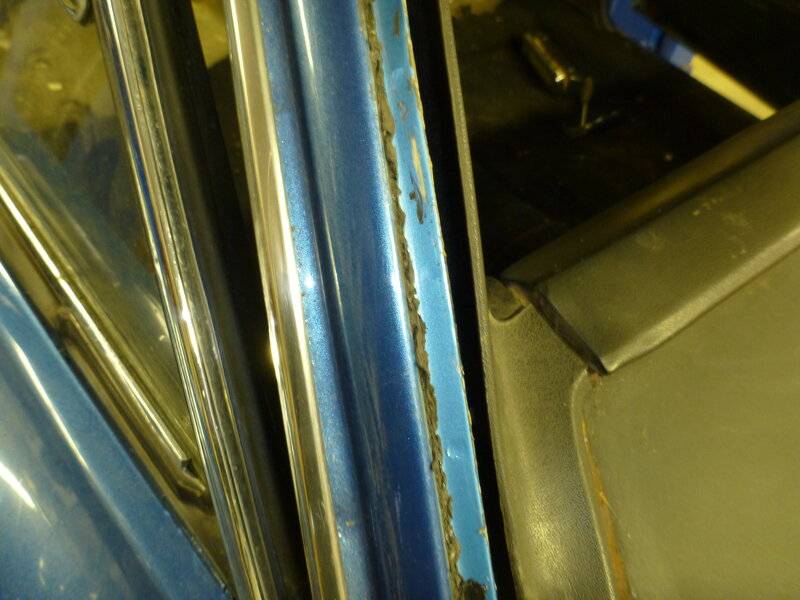

Maybe print out the paint color sheets on paper, then hold it next to a spot on the car where the original paint remains. Under the speaker deck/package tray, inside the trunk, underside of the hood, under the carpet etc.
Not sure how well your car has been painted in the past, but you could try removing something on the fire wall. It may have the original color under it, or trunk latch, sills, something like that. Then you can cross reference paint chips for 68 Plymouth to match it up.

Lotsa original paint on the rear package tray area too if it hasn't been resprayed very well in that area. My 68 is completely covered up there in original E1 color.
There is always somewhere on the car that is original color. Nobody is that good!
Pull the windshield out....that's where I found pristine FC7 paint from the factory....
Most 'average' car painters are too lazy to pull the windshield out. :thumbsup:
