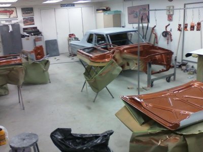

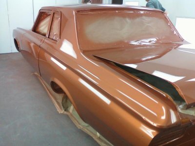

My 64 Dodge is in the paint shop now. We removed the fenders, hood, and all front sheet metal. Also the doors and trunk. All body work was done and under hood- door jambs- under trunk lid, etc. was painted the body color that it will be. That way, all the parts can be re- assembled, panels, etc. straightened and then the whole car can be painted at once- making all the paint match. And less chance of scratching new paint in re- assembly.
Just throwing another ideah out there.............................MO.
