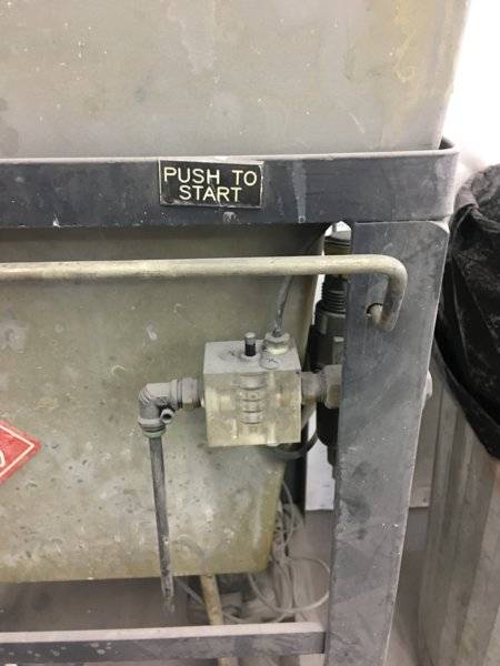

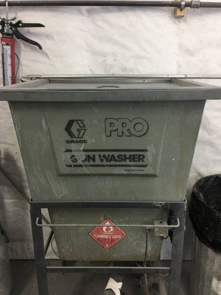

Hey folks, anybody know a thing or two about paint gun washer? I have a Graco pro gun washer and doesn’t seem to turn on anymore. I had it for about two years and it’s air operated. I push the button to run it but nothing happens besides a hiss sound coming from the valve where the button is. You should be able to push the button down and it turns on, shutting off when you open the lid. I checked all connections, air lines, have 60 lbs of air going in. Any ideas?

Open and close the lid a couple times maybe the lid switch is sticking. You could also put a few drops of airline oil in before the start valve . Gently tap outside of valve with something that don't spark. Its either a switch sticking or the valve went bad in my opinion.
Probably moisture in your switch, if I were a betting man...
I’m thinking the valve is junk. Spent like an hour checking everything but no luck. Thanks guys
