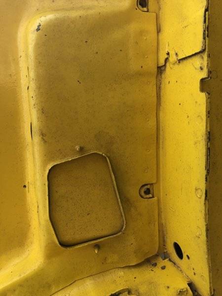

This is what mine looked like when I bought my car 2 years ago, but I'm sure it didn't leave Hamm looking this way.
Your Charger, I believe, would be a Hamtrack car.. so it would have the left screw painted, tag bent and right screw plain.
Could have been a St Louis car too? Or LA plant?
