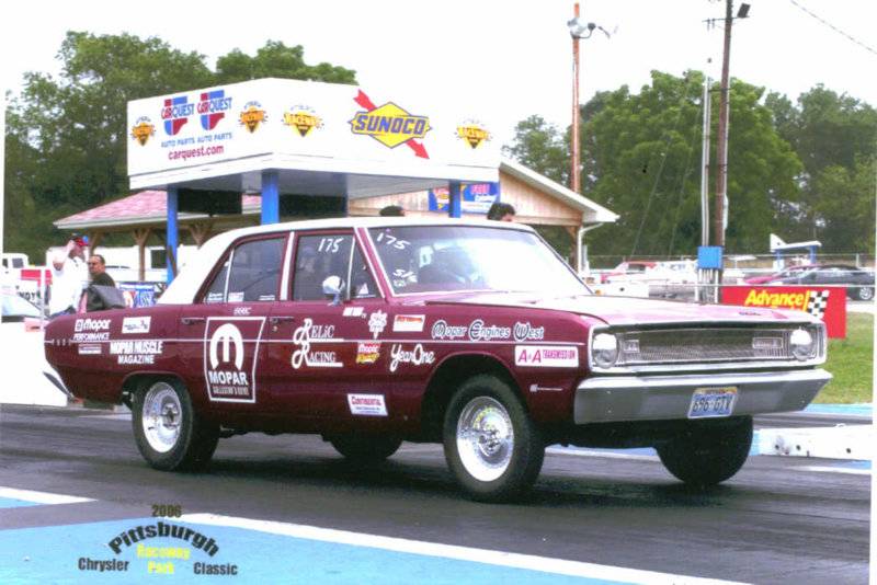

Had this one dyed/painted in 1996. When it was street driven.Still going strong today. A body shop did it. Have no idea what they used.
