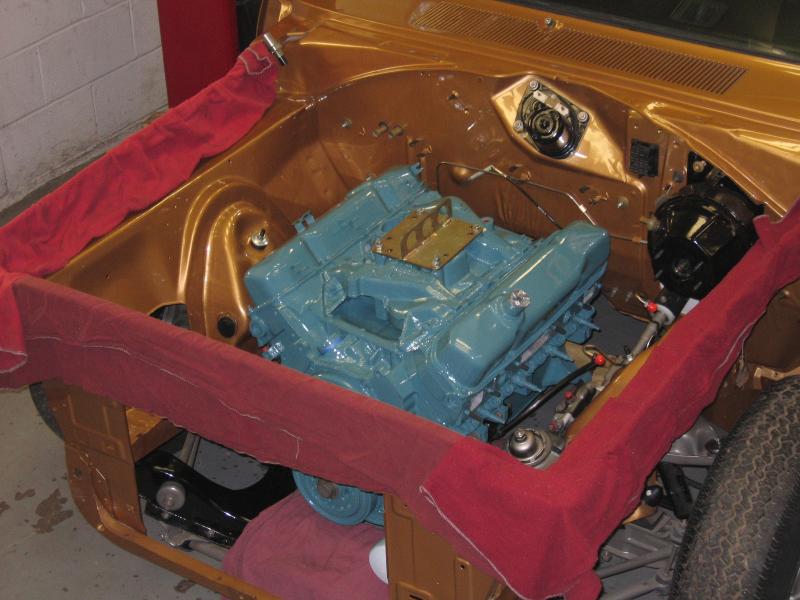

moparmarks,
In your first engine pic, looks like you painted aluminum heads. I plan to do the same thing. Did you have to do any extra prep for the aluminum? Scuff 'em up? Etching primer? ?? ??
moparmarks,
Yes I did. No extra prep. I do use motor primer. I have not tried etching primer on the block and heads yet. Have on the backets with good results.
Also notice that the motor in the first pic is Chevy orange compaired to the others that are Street Hemi Orange

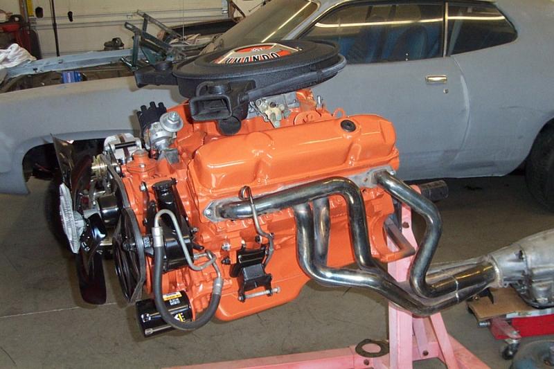

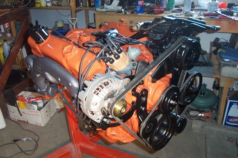

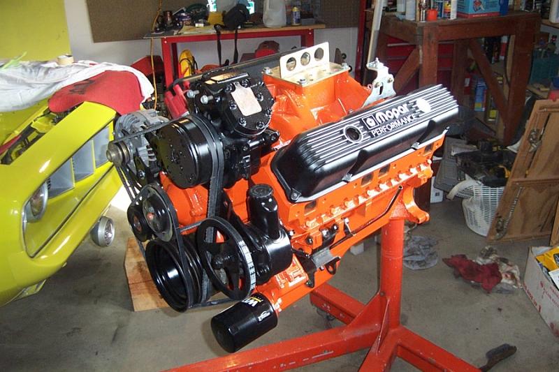

Good reference photos of what to and what not to paint. I'm gonna paint soon too.
