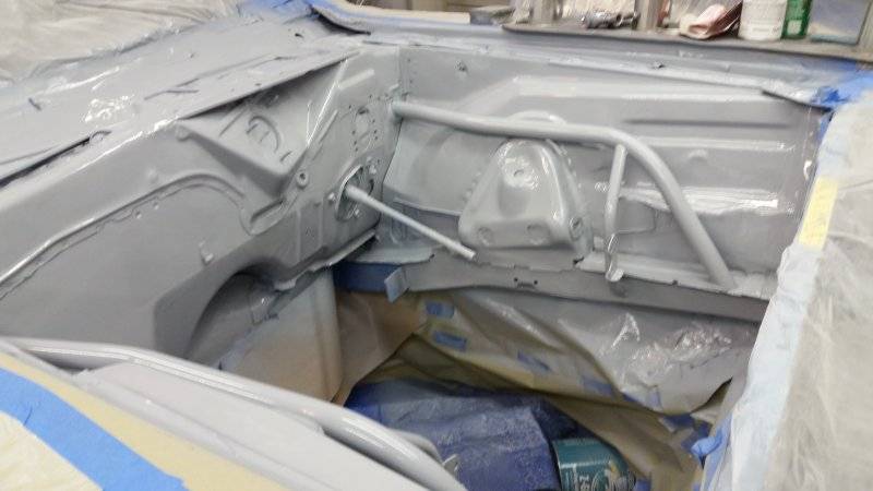

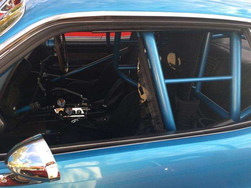

We sealed, primed and painted with base coat, clear coat. Have the mix from when the car was painted so the match is perfect. Painted my cage with the same paint.

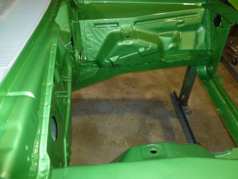

Mine is 69 Dodge f6. Chose the color after seeing it on a 6 pack Super Bee.
The F6 looks nice. I've sprayed F5 single stage in the past. The green shades seem to vary the most depending on the color of primer.
Great choice!!! Around 1990, I met a guy that had 2 of these A12 cars in his garage in F6. Amazing to see 2 but the more astonishing feature was that they were sequenced cars off the assembly line!!! No kidding.....when they came to the Dodge dealers in his small town, he kept track of the two owners over the years was able to buy both!!!! What a package that would have sold for had he taken them to Barrett or Mecum!!

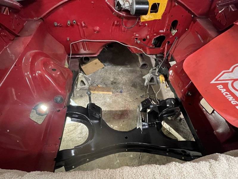

Tonight I’m painting the K frame red. I’ll get to the inner fenders and firewall this weekend. Thank you!
