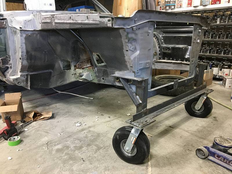

Pic of car as it sits now, at the body shop...

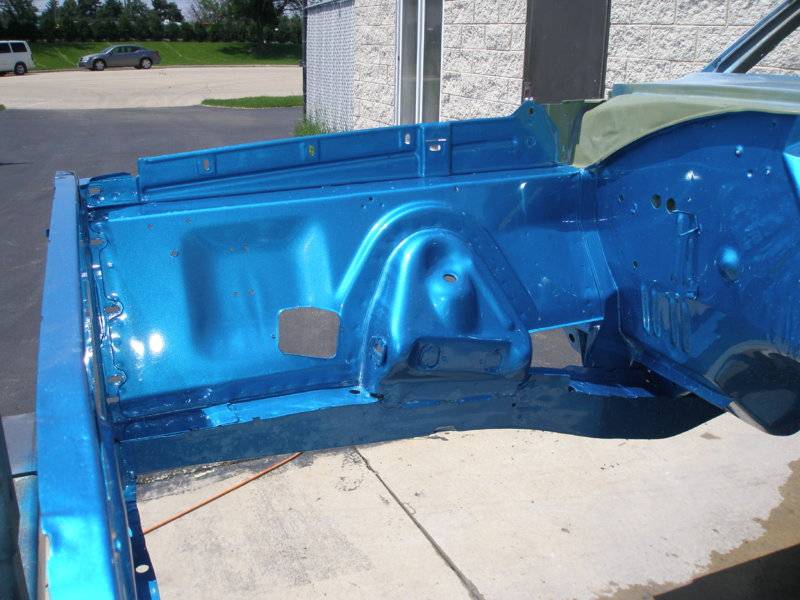

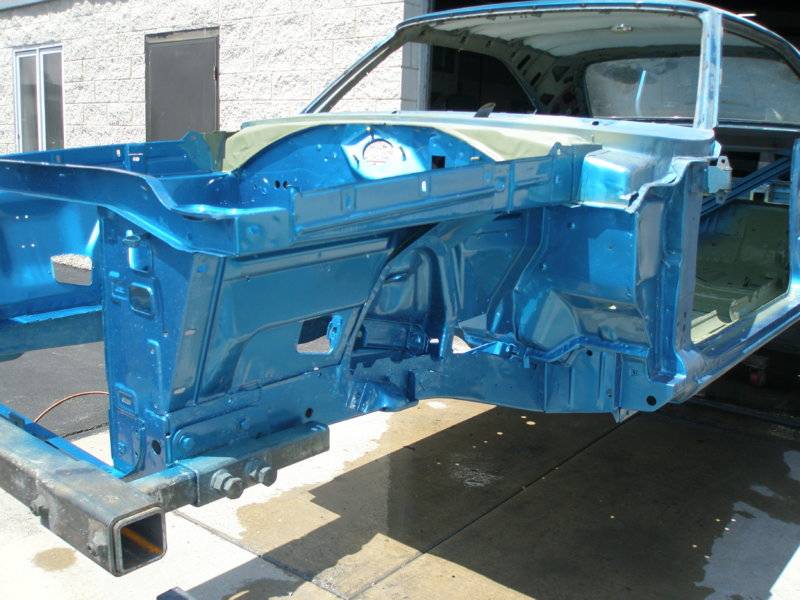

I sprayed mine with urethane. I think it was called Nason Fullthane from Orielleys. Used a wet look hardener. If you want the factory look, then runs and orange peel are a must.
I painted mine masked off like this: Paint the fenders off the car and paint the bolds separate just making sure that you keep the paint to a minimum. Buy a set of the nylon lined sockets to install the bolts and you won't have a problem.

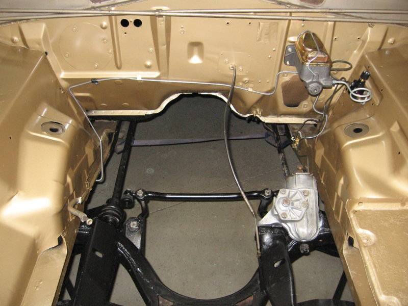

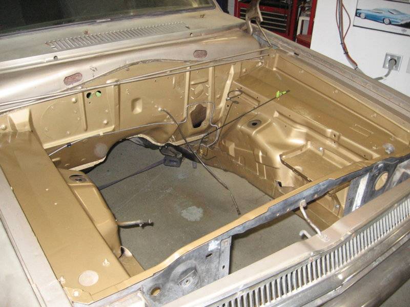

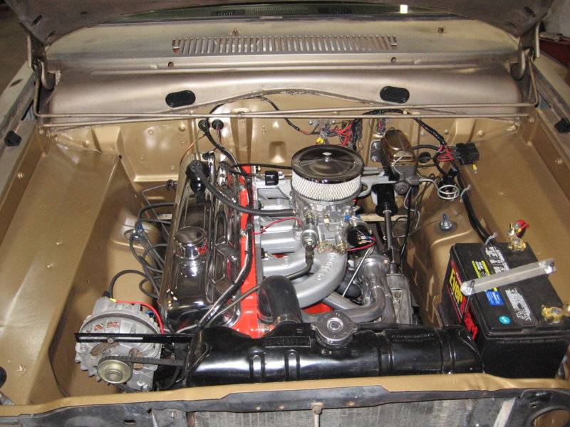

Yep did my 64 Dart like zyzzyx. As you can see the fender rolls over the inner fender so when the car is put back together you really won't see mask marks. At the cowl part line you will never see them.Like you, I wanted to get it up and running to drive and do the rest of the paint when money allows.
Did mine the same way as the other two. Just find a good line or separation to tape on.
