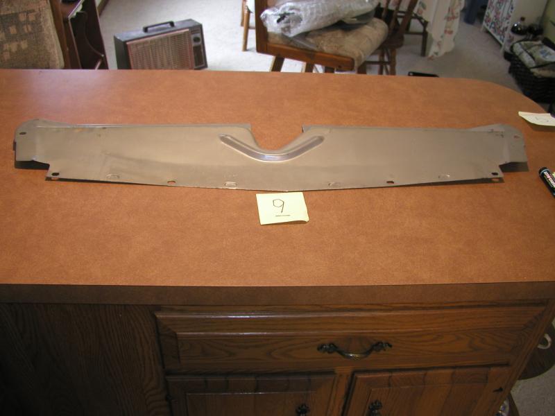

Lower radiator splash/rock shield is black as Eagleone stated, not body color on a '69 Bee. It might be body color on other cars, but NOT on a '69 Bee.
Here is the radiator splash shield. Mine has been stripped and not repainted yet.

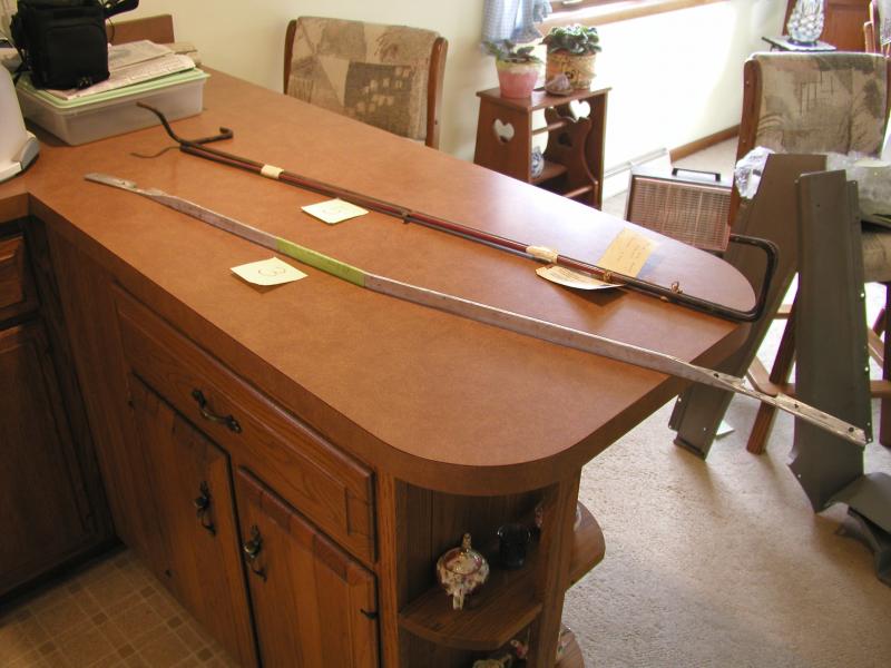

Here is the front lower hood trim, also stripped and not repainted yet.

The pieces in the photo's are exactly the pieces I was referring to. Protective tray - Black... Hood lips,, Body color.
Thanks a million!

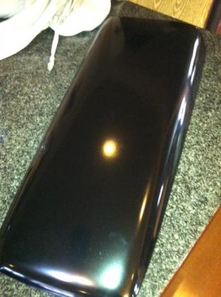

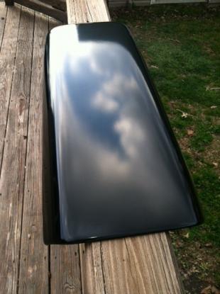

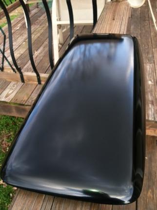

I picked up my scoops today. The painter painted them Satin black. They look a little too glossy to me.
Thoughts?

Sorry, can't help you with the scoops. Mine are body color since it is an early build '69. I have heard the '69 Bees with the black scoops were part of a "Spring Special" package and were of course built in early '69, March or April I think. I don't remember the sales code for the Spring Special either and don't have any of my reference materials with me to look it up for you.
V21 Performance hood treatment (Scoope painted black) - this came from Andy440 owner/operatoer of the 69 Superbee registry of America.
Does that sound right?
