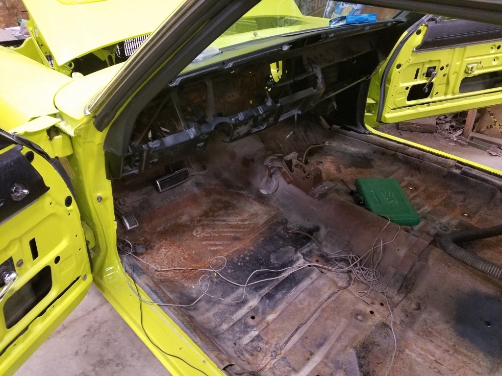

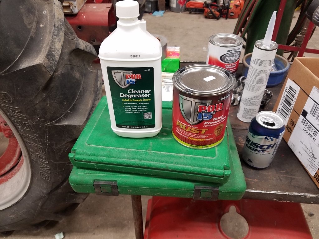

I got some POR15. And some seam sealer.
Before I start I have a few questions.
1. I found some places where it looks like it would be a good idea to put some seam sealer on before I paint. How long does it need to cure before I paint over it?
2. Im guessing I should just paint over the body plugs. They are likely old and brittle. Is that the correct thing to do?
3. How far back do I paint? Into the trunk or stop before then?

The rust is only minor surface rust. I have some rust killer and got some grey primer. I'm not sure which if I will use the primer or the POR15 will probably be a decision later today. I will try to remove the plugs. Instead of painting over them.
I'm not sure why people bash POR15, I think the stuff is amazing.
It is very hard to remove later but that is the on drawback that I see...I'm going to be using it on mine....
I think I'm going to use the POR15 it will preserve the floorpan on the inside just like the rubber undercoating preserved the outside
Just clean it as good as you can ...go to town!. Wear 2-3 pairs of gloves!

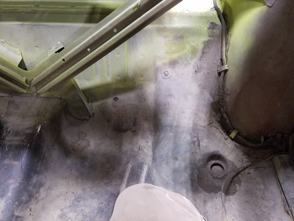

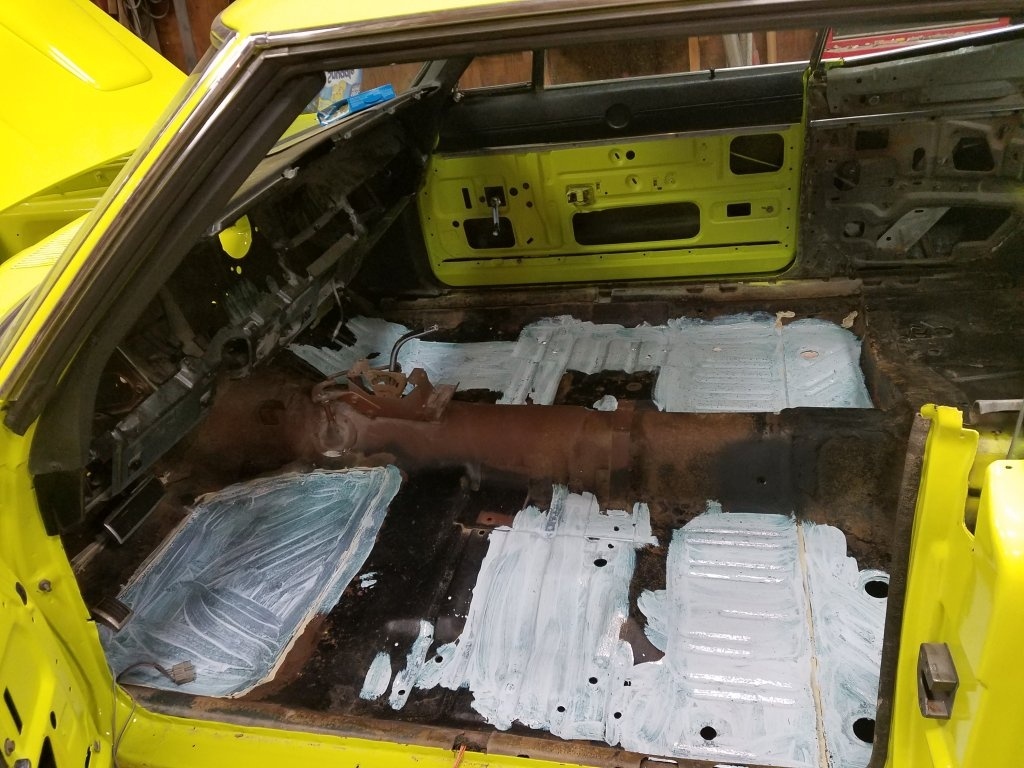

Wire brushed and wire brushed and vacumnEd and cleaned the floorpan with this stuff. It works really good, but be careful because it's hard on the lungs.
Then I applied some rust killer, (probably not necessary but why not?) And reapplied some seam sealer because cleaning the floor made most of the original come up.
The rust neutralizer dried to a dark translucent color. I forgot to take pictures but it is looking like a good foundation. Tomorrow after work I will apply the POR15.

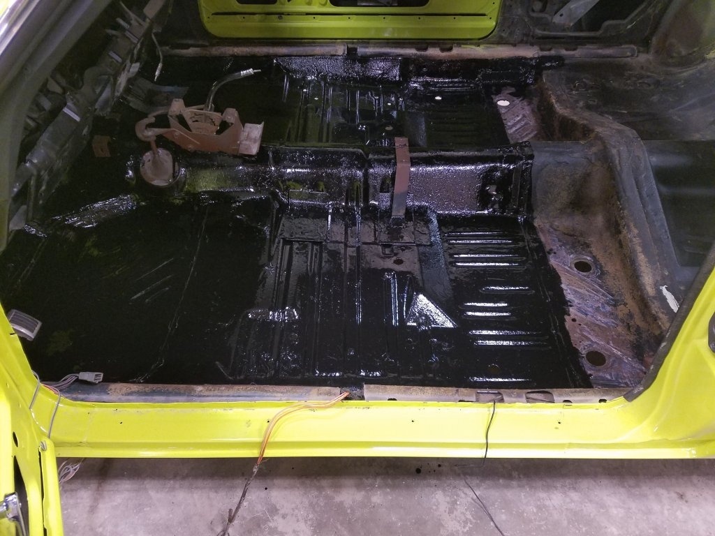

Got the front part of the floor pan painted with POR15 up to the firewall tonight. Tomorrow I will do back to the trunk and up the firewall.
Like the stuff so far.

The POR15 cleaner and POR15, a tube of seam sealer and a box of 50 rubber gloves was $94
I looked for Rust Bullet. Parts store didn't have it. Given all that Ivery already invested what's $94.

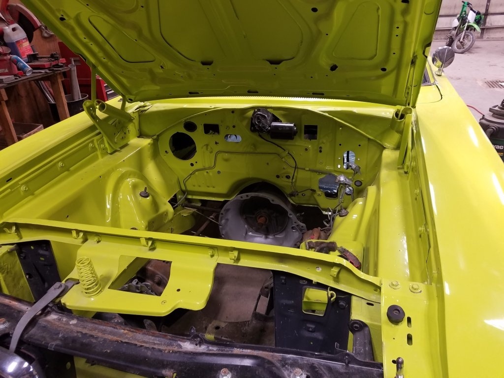

I question if painters tape will hold the stuff back. I don't want POR15 going through the holes of the inner firewall into the engine bay.
I have done it, use a good tape an use a felt squeegee to make sure it stuck in there, do around all the holes first, then paint the bulk of it. wont be an issue.

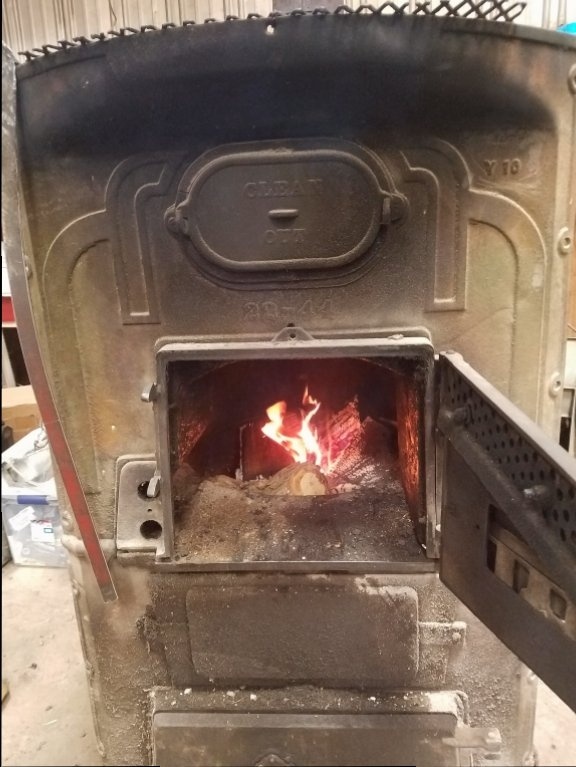

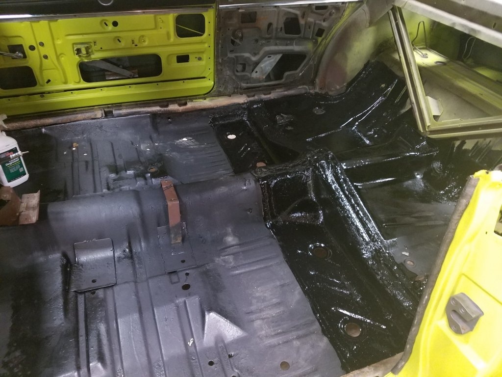

Finished painting the interior. Painted as far as I could up the firewall back to the trunk.
Despite it being 45 degrees outside I still built a nice fire and got the shop heated up to 70 degrees.
Should help the POR15 on the floorpan as well as the heater box housings that I rattle cannes dry nicely.
Tomorrow the MC/Booster go back in.
