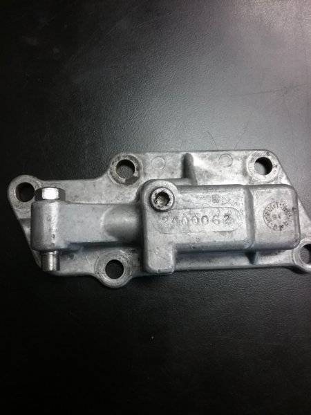

I'm looking for a park cable housing for my A727 Torqueflite pushbutton trans. Mine has pinholes and hairline cracks. If anybody has one they're parting out, I would appreciate a call. Dan Wilson (205)907-220

Can you file the gasket flange flat and fill the pin holes with JB Weld? Torque these to factory specs too.
Mike
Nearly every one I've seen is warped, easy fix with a flat file and stone. I've seen pitted ones, easy fix with JB weld. I've never seen a cracked one. Where is the crack?
