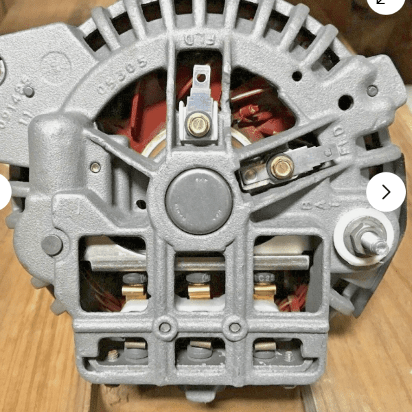

If your alternator is working, the armature bearing cap on the rear of the alternator is magnetic.
