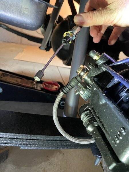

Hey guys. Just got my parking brake cables from Dr. Diff and I'm not sure how they install. It looks like the end just slots into the bracket, but doesn't seem to have a clip or retainer in that spot. Do I just pinch that bracket together? Also, is there supposed to be something on the axle housing to hold the cable in place?
Thanks!

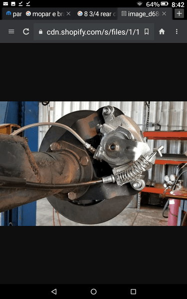

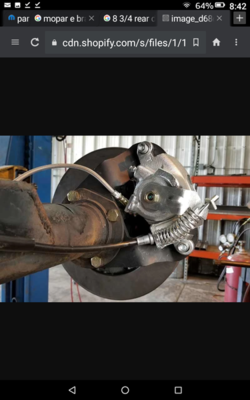

Looks similar to a kit I used. With that said my cables were feet to long so I used the oem ones. It should hook into the brake caliper lever and I don’t use a bracket on the diff there is a u shaped part mine go to and connect to the forward lead.
The u shaped part I bent to allow the cables on and clamped tight

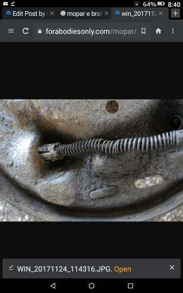

Looks like a cable for a drum brake. Or could this be it?

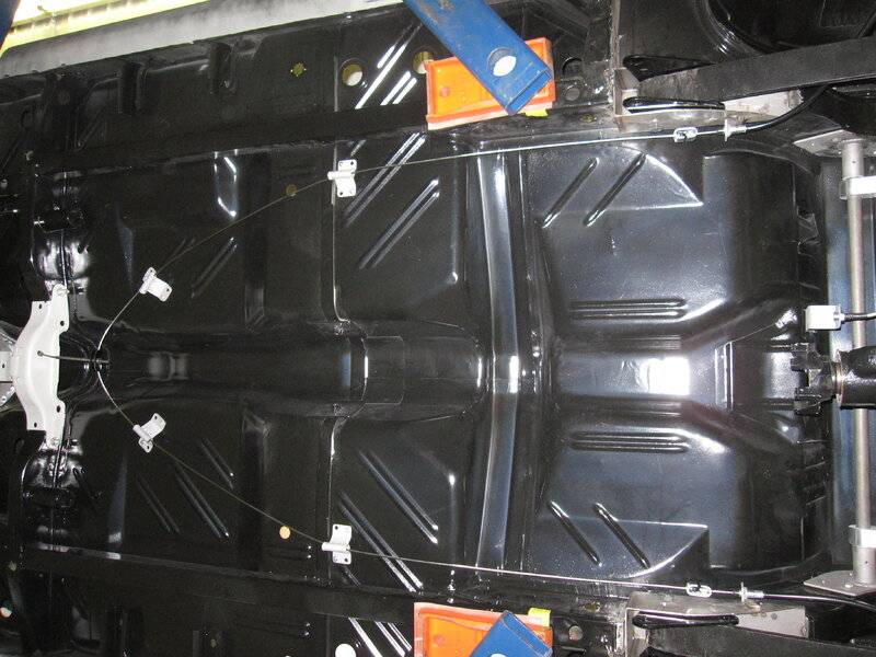

I fabricated a couple of angle brackets and welded them to the frame rails to hold the front of the cables.
Well I figured it out with some help from Cass at Dr. Diff. Let's just say, I'm not the sharpest tool in the shed.
