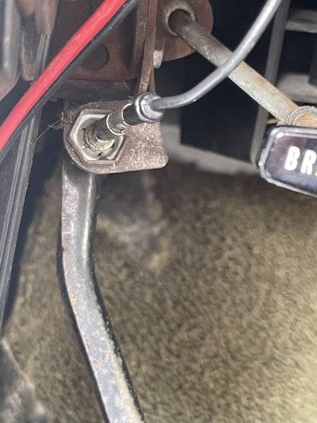

There is a switch on the pedal that grounds when the pedal is pushed. Make sure the plunger works and it is plugged in.
A little description where the switch is located in relation to the parking brake pedal.
Thanks again
look at the E Brake Pedal itself....follow it upward...you'll see a switch like the domelight switch in the door post. Might be a broke switch, or the wire to the switch.

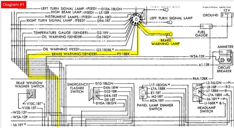

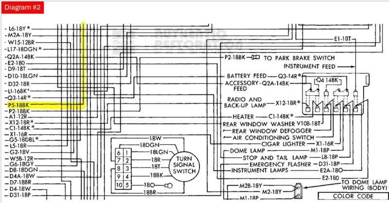

I found the gromet for the switch and found the drawing in my "Service Manual"
No switch there. No errant wire visible either....
When I checked my wiring diagram it shows the wire from the "Brake Failure Warning" (from the distribution block for the brakes) and that connects to the "Brake Light Switch".
On my brake pedal there is the brake light switch connection and a second elect connector. Could that be the connection from the parking brake?

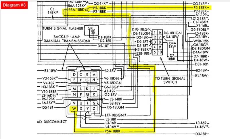

I am pretty sure the (emergency) brake light is/should be activated by one thing only: the emergency brake pedal. Pressing the normal brake pedal should NOT activate the light. The (emergency) brake light is only there to remind you that you left the emergency brake engaged. That said, you may have at least two issues: 1) As you've identified, you're missing the plunger switch (and associated wiring) at the emergency brake; this would explain why engaging the parking brake doesn't light up the bulb. 2) There's a short somewhere that occasionally closes the brake light circuit, lighting up the bulb. I would use your electrical wiring diagram to chase the wire back from the bulb through the ignition switch to the bulkhead connector and then, from the engine compartment side, chase the wiring from the bulkhead connector to the plunger switch (which you may want to buy). Even if you decide NOT to put the plunger switch in, you may discover what's shorting out to cause the flickering. I don't have my RR manual anymore (sold my 69 a while back) but I suspect it's similar to my Coronet in which case, you may want to focus your attention on the W slot on your bulkhead connector. The W slot is the lowest slot on the left hand side as you're looking at the connector in the engine compartment. I'm guessing there might be a loose wire or a cut wire that might be grounding out. ...or not: electrical is mind-numbing....

I was wondering if there was something else that might trigger the brake light but I just couldn't see in the the electrical diagram where that other something linked to the brake light bulb. Maybe it's the P2-18BK wire in Diagram #3.... (God, I hate electrical....)

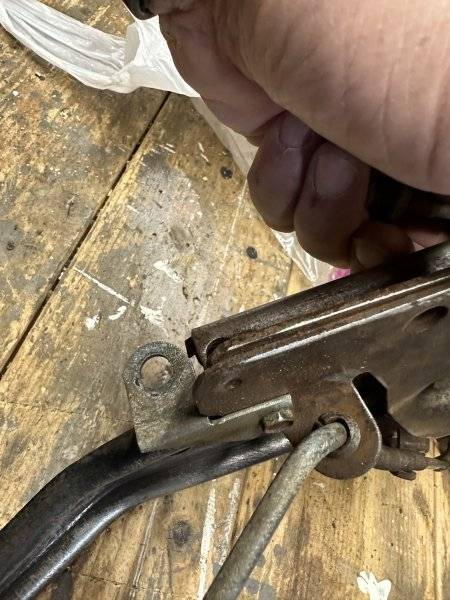

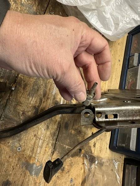

Here are a couple more pics of the e-brake plunger switch and mounting bracket if you need them. (If the plunger and mounting bracket are missing, these pics might help.)
