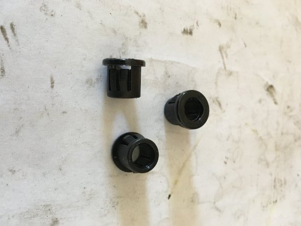

plastic piece on brake lever from emergency/park brake -
- where to get?
- or how to make or what to use..
- what would the name of this part be?
Mine is crumbled and broken...
Thanks, pieter

Here's my hot tip: put them in backwards - no they won't be original BUT the spring puts force on the small flange and has a tendency to push the piece out. Putting it in backwards puts the large flange against the spring and it can't push out.
