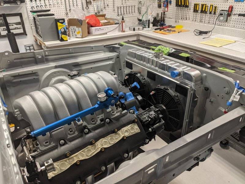

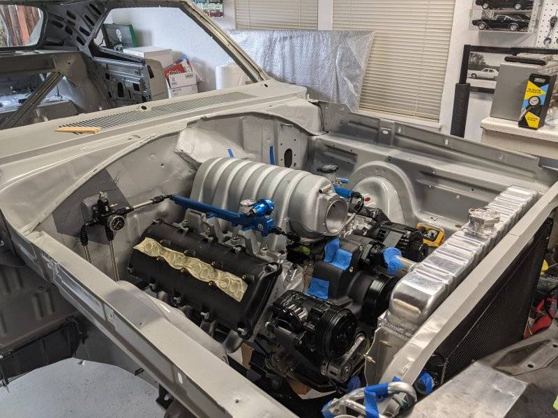

PS - anyone notice I have (unintentionally / idiotically) installed TWO fuel pressure regulators -- doesn't seem like this can hurt....thoughts?
I know some diagrams show it as acceptable but I don't build a fuel system to flow -through- any regulator. It's always only on the return side.
I would remove the one on the firewall.
Interesting, thanks for the input INTMD8...I got a few separate diagrams from members here and some from the internet generally, with this dead head system they showed the regulator on the supply side. Appreciate your thoughts, I'll keep them in mind.
Yes there are some diagrams like that and I'm sure it depends on what the regulator looks like internally compared to others.
I've just tuned a few cars that were dropping fuel pressure that were fixed by moving the regulator from flow through to the return side.
(if you tested pressure at wot through redline and it doesn't drop, would make no difference either way)
On most cars which have EFI added, the regulator is on the return side.
Thus far I have built 3 cars with EFI and am working on the 4th and 5th, all of these the fuel regulators are on the return side.
My 95 Dakota is a factory dead head system and the regulator is on the pump in the tank. And I'm interested in knowing what transmission you are running and if you had to do any firewall mods to get it to fit....

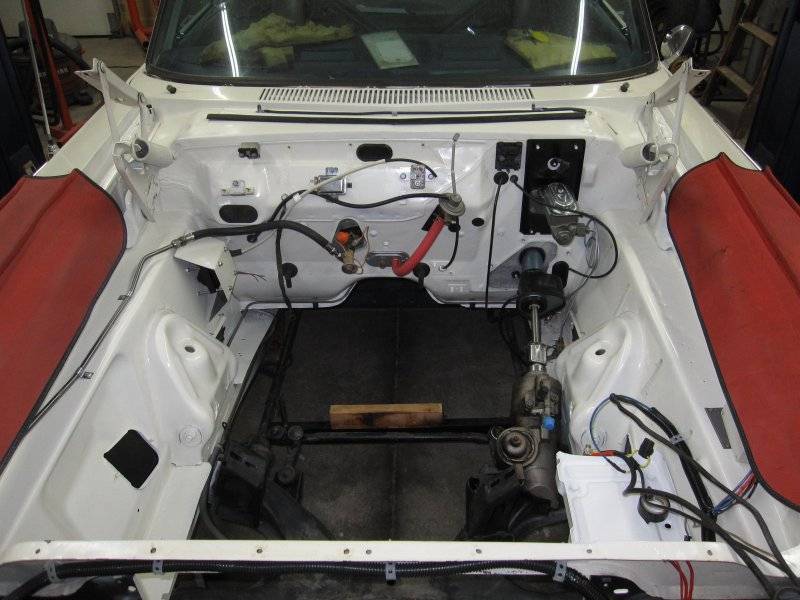

I just wrapped up my Infinity Box install. The front power cell should be in the front of the car. Now, I did not have all the room you have behind the grill so my PC is under the dash. You need to keep the PCs cool so putting them in a box will not work. You also need access to check any problems and fuses. I used a aluminum shield on my 65 Coronet to hide the coil in the engine compartment.

I plan to put my infinity box power cell for the front electronics (Box 1 of 2) in the dash area behind the firewall in the cabin - or on the console somewhere.
Wow, really nice build Mike. I really like that aluminum shield. I am thinking about a similar shield for my gas lines as they pass near the headers when they reach the engine bay.
I mounted my front cell on a bracket that covers the E-brake pedal assy. My Master cell is on a panel behind the glove box door. I built a console with a box on top for storage.
