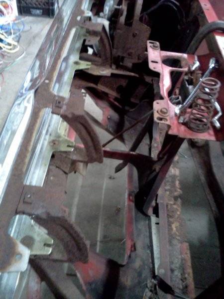

Hood release bracket
a little crusty but solid
rod grommet is present
I hit it a bit with the wire wheel to clear some crust

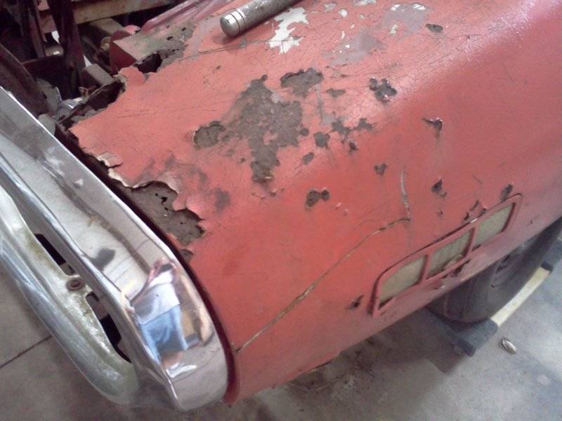

driver's fender is NWR IMO, unless you need a patch from the center arch, or the marker light area to convert a 72 fender

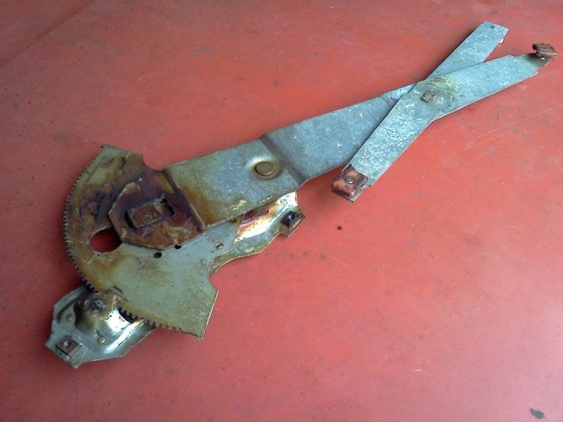

here's the driver's regulator
That was fun to get out

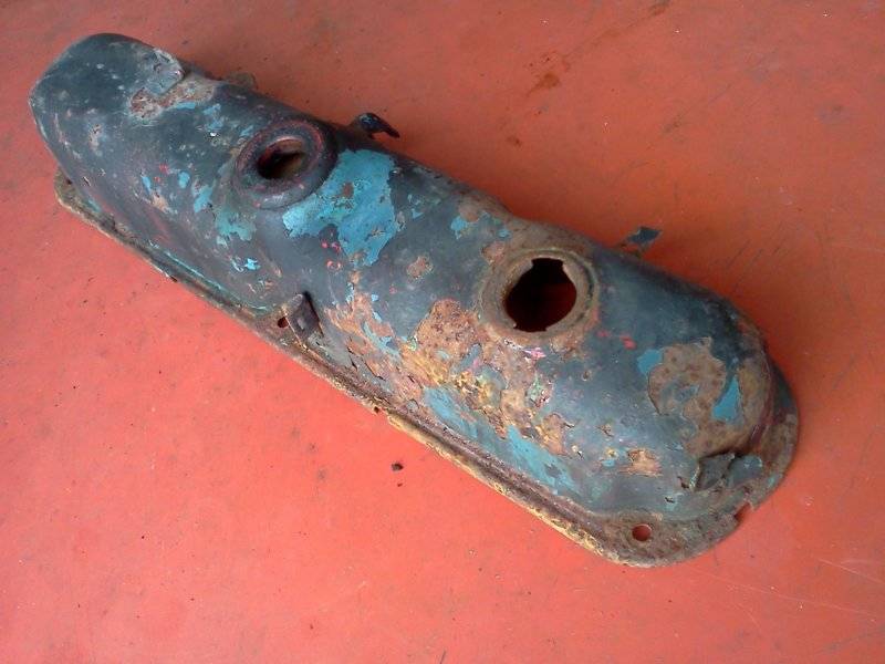

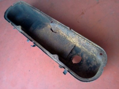

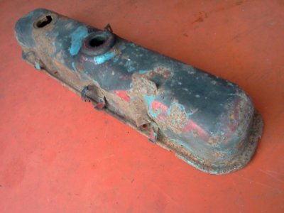

Someone was interested in the valve covers.
Only one and it's crusty
