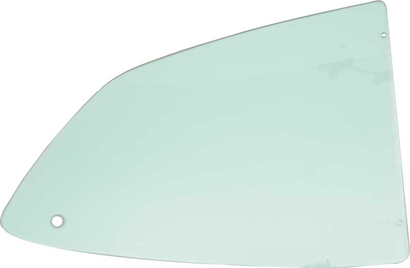

I would assume though that they are held on by some kind of adhesive or maybe it sort of slides over with a backing plate and screws into the quarter glass. I found this picture on Classic Industries website and it looks like toward the front end of the glass piece there is two holes where it would appear that the trim pieces would slide over and then be attached via a screw/bolt.

The ’71-72 glass has a different shape than what is pictured, and there are no holes along the front edge for any kind of fasteners. It’s a pressure/interference fit, never seen any sign of adhesives used originally.

Figures they'd show the wrong picture, I kinda figured that it would be a press fit deal like you said after thinking about it more during my drive up to classes today.

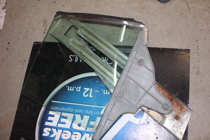

eeehm, need to note 71 are diff from 72s even the same quarter opening shape.
71s are small squared mounted on a pot metal bracket or frame, for a while 72s are big glass with the hole for the fasteners to the chanels sliders, just like fronts.
quarter glass posted seems to be A body fastback
and about the trim... need to remove weather strip, which are slided into holes to the body... then will reach the outer molding bracket screws.
before that, of course all the interior trim
71
72
This is talking about hardtops. Actually not sure if coupes are diff.

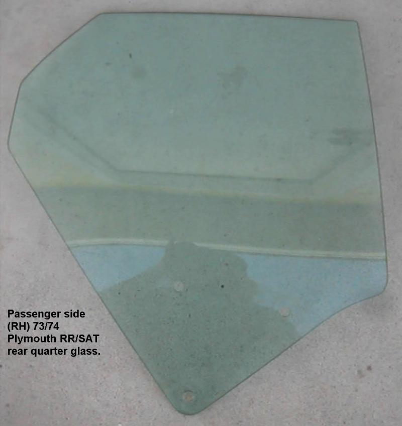

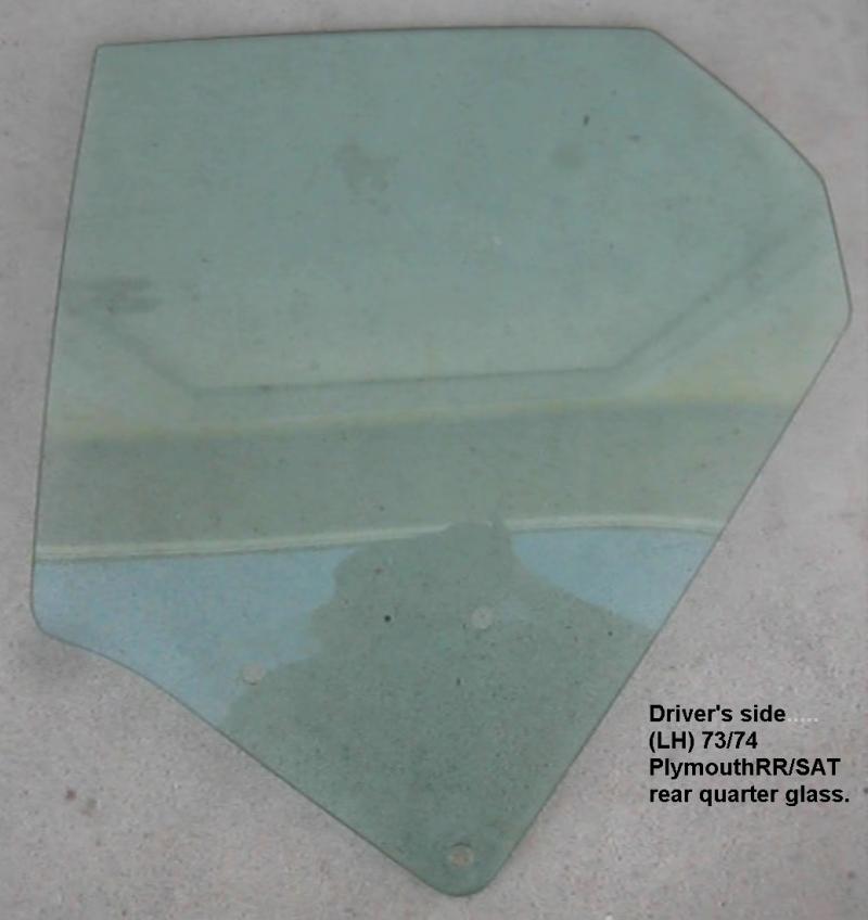

I'll add some info here to help out. Also I've wondered if 73/74 Plymouth quarter glass is the same for 71/72 Plymouth quarter glass and 73/74 Charger non SE. Below are pics of the bare quarter glass from a 1973 Plymouth Satellite Sebring Plus (2 door). The trim was removed and it was held in place by a press fit.
Thanks, Bryan
