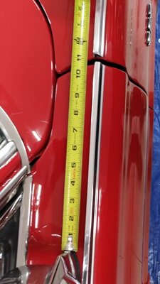

This is the info I used on my 66 Charger to place the pass. mirror. It was written in 2005 by Terry Hoover.
"It's difficult to get and exact measurement since both mirror assemblies tilt forward as they go up. But measuring from the top front edge of the door (the top edge of the door at the joint with fender) while holding the tape along side the top stainless trim line, and measuring to the lowest front edge of the mirror assembly."
Drivers side = 9 1/4 inches back from the door edge
Passenger side = 11 inches back from the door front edge
Both seem to be equal distant from the outside edge of the door. The mirror base is curved but at the peak of the curve they both appear to be 1 1/8 inches from the top bend on the outside edge of the door.
Note: Mike Peters measures both non-remote mirrors on his 66 at 7 5/8 inches from the front fender.
I used these measurements (which took awhile to decipher) and double checked to make sure the vent window would open.

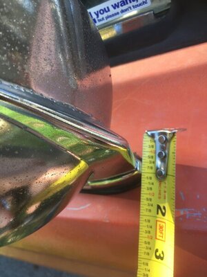

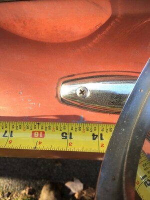

Here is both sides
IMG_20201105_111259.jpg IMG_20201105_111244.jpg IMG_20201105_111229.jpg IMG_20201105_111215.jpg

I have installed passenger side mirrors on my 65 and 66 Barracudas and my 66 and 67 Chargers.
One thing I've found is that the driver side and passenger do not sit at the same measured spot on the door. As stated by another post, it's best to sit in the drivers seat and have a helper position the passenger side mirror in the best location with the vent window open to eliminate interference.
Use painters tape to keep the paint safe.
Also, the mirror is attached using one sheet metal screw and one stud with nut. If you elongate the stud hole a little bit, you will have some additional final adjustment after installation. The adjustment will pivot around the sheet metal screw and the stud can be tightened to securely hold the mirror in place with a slightly enlarged hole.
