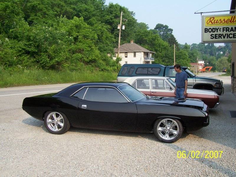

Back in 2007 we built this 'Cuda with one behind a 451 B engine and 3.73 gears.
Did a long haul Hot Rod Power with the car and put 5,000 miles on it.
Car got 20 mpg cruzing at 65 mph.No power steering or brakes,no A/C. Car is still running around to this day.

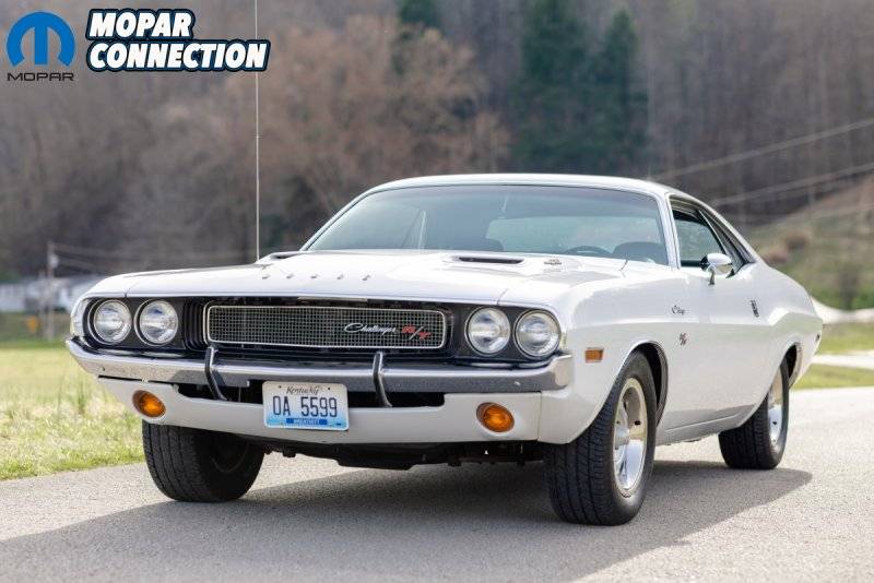

I've had one in my challenger for 5 or 6 years now, getting close to 14000 miles on it. I love the gear spacing (rpm drop between gears) and the cruise rpm with my 3.54 dana axle. OD drops rear gear to about 2.8. Only complaint I have at all is it seems noisy in OD. Granted my car is very quiet inside with complete stock (Accurate LTD 2.5 inch) exhaust. It is probably as quiet as could be expected. Just my experience and 2 cents. (note: I only bought the gear set from Passon, built the transmission myself)

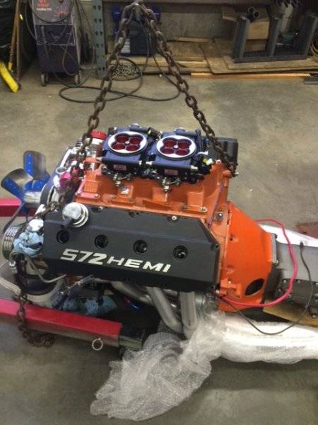

I have the "clean sheet" Passon 855 5 speed. Passon had been modding the gearset in the 833 for years, which uses the factory transmission housing, etc.
The 855 is a whole new creation.
Mine has been great, and I'm going to be putting it to the test behind a 572 RB

If you mean his 833 with 4th as overdrive then yes it works well.
Car got 20 mpg cruzing at 65 mph.No power steering or brakes,no A/C. Car is still running around to this day.View attachment 1303209
