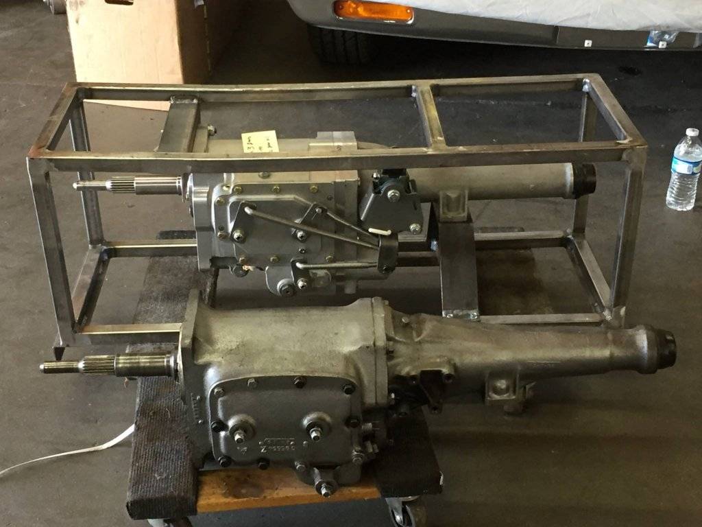

Someone say pictures!
Here's one!
I'll see about pix. I have a couple before it was in, and can take a couple of it installed tomorrow.
