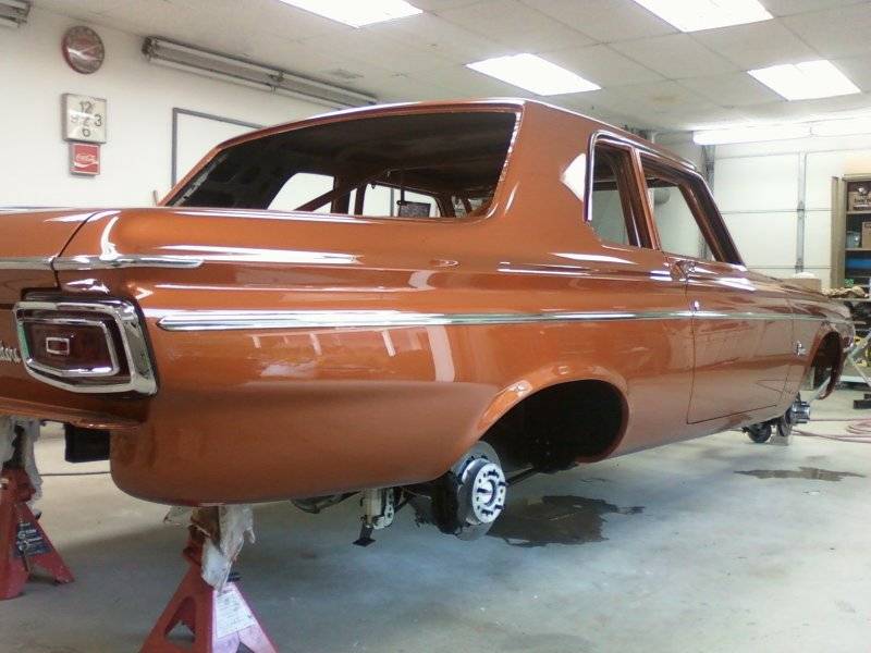

When doing my 63 Plymouth, I needed patches for the quarters and other small places , I got a sheet of 18 gage and cut out bucks of hardwood to shape the patches with. Nothin to it the way we do it!

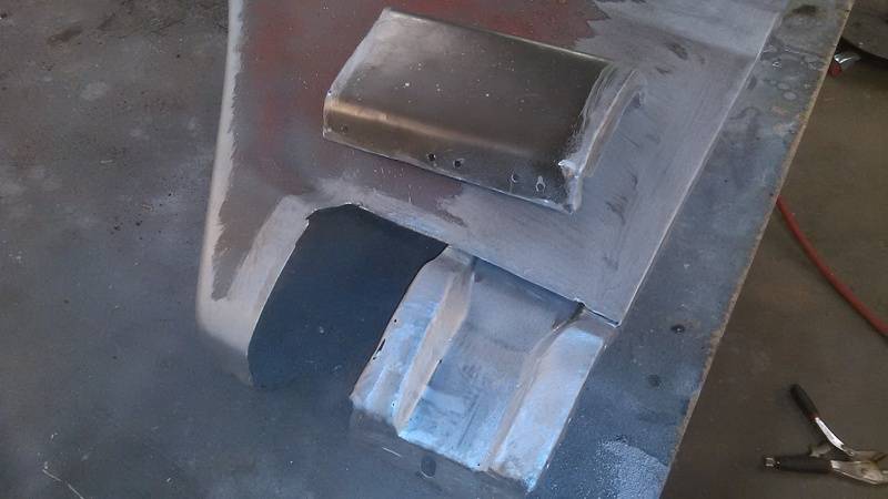

Fitzee is no concours metal shaper. But he provides good solid info that home builders can follow. I've watched him for a few years. Lots of good tips. For the pipe fixture he has I use PCV clamped to the bench. Shim it off the surface with a couple of 1/8" pieces of scrap. Various sizes of PCV will allow you to make different radius. Welding the corners inside and out allows you to round the corners without fear of breaking thru. Take your time. You can come up with excellent results the first time. I repaired and stretched the rear wheel wells on my 64 Belvedere. I had welded a few patches before but nothing this complicated. Look close and you will see the weld lines. The corners behind the wheels were gone. I made templates from another car.

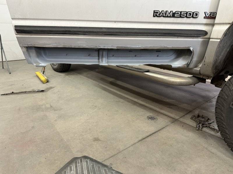

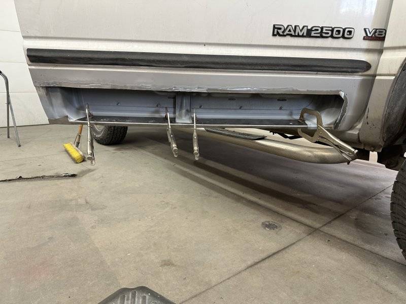

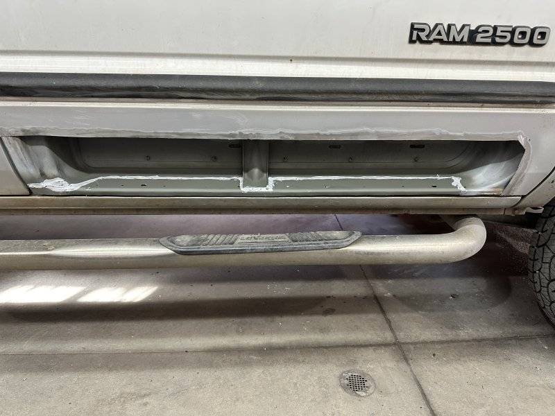

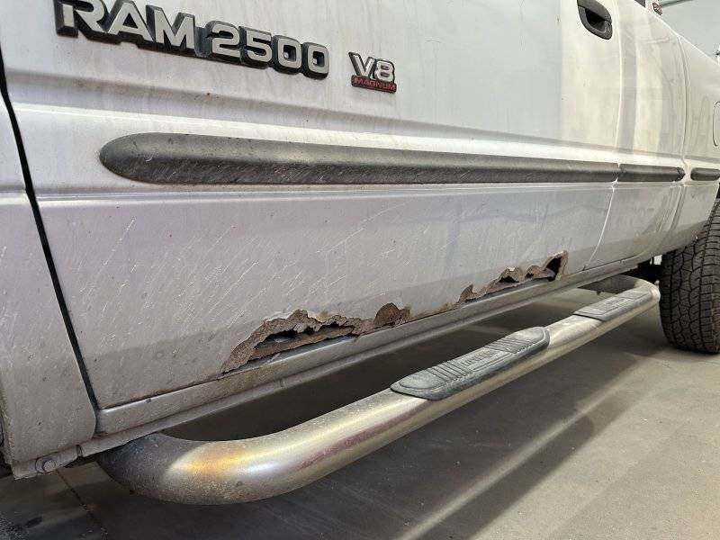

I recently fixed the rot on my old 98 Ram. Not show quality but better than rot holes you could stick your fist through. The first mud hole I hit made the paint match perfectly. $40 patch panels per side. Had to fabricate the lower door frame patches.
