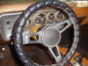

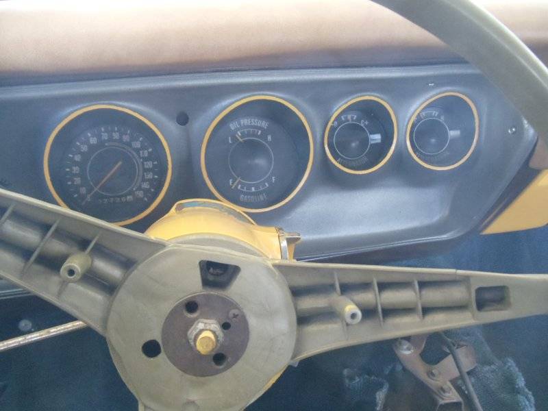

Not everyone's cup of tea-I went with a textured silver after having filled in the butchered radio spot with a metal plate behind and a two-part epoxy over the top of that. Highlighted the gauges with a yellow that almost matches the Bahama Yellow exterior.
