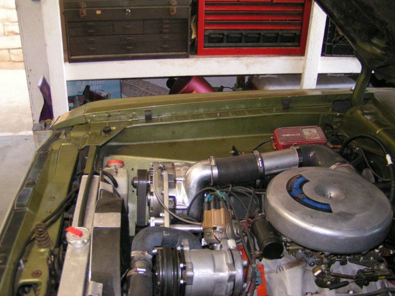

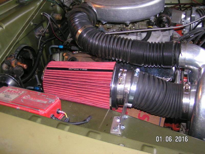

Ok, here a a few more of the motor, and one of the dash. Speedo looks like a 69 RR. IS THAT AN A BODY?

Ummm the 1st pic of the duct going into the hat is correct....the second shows a flex line...That flex line I doubt will hold boost for very long. You need hard pipe and silicone boots.
On the intake side the same flex line could colapse due to the suction...
That flex line looks like its from a cold air induction set up, not for boosted applications...I could be wrong but I have never seen a flex line like that for your application...

Agree with mike, 2nd and 3rd pic Set up will not last past 1/2 throttle

The first pic is the current set up. He must have been doing some experimenting in the past............ I was just saying that

Do not be afraid to run the blower do some research on the hoses- there are hoses made for pressure/ intercoolers tc
