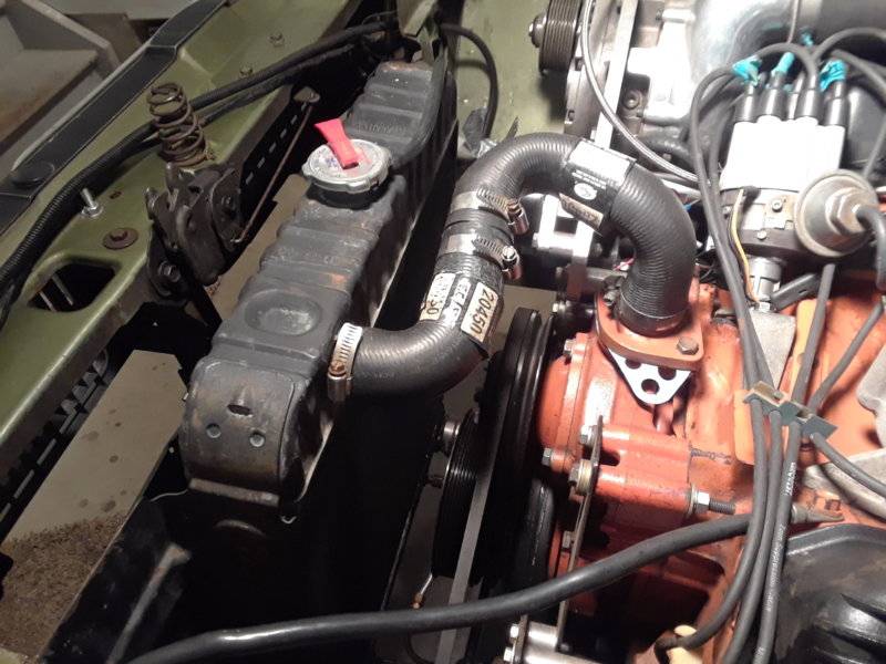

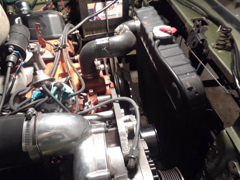

Car ran great cruising for 2 hours at 85 MPH ON THURSDAY NIGHT, going from Green River Utah to Grand Junction.Then on Friday morning I accidentally damaged the radiator, at the hotel in Grand Junction. Stop leak wouldn't fix this one. LOL . So I called Moparmarks, who lives there and specializes in old Mopars. He had a 6 cyl radiator with the correct side hose outlets, and he kindly let us use his shop to install it. The fan wouldn't fit in, so being that we would be on the highway for the last 250 miles, we left it off. Water temp never got over 190, even going over 10,000 foot Vail Pass. Then on the way up to the Eisenhower Tunnel, the alternator stopped working. It was getting dark, too. Waited until we were through the tunnel to turn on the lights because after that it was downhill most of the way to Denver. Still had to stop in Idaho Springs and charge the battery for 45 minutes. Plus the 727 trans would occasionally release the high clutch, and the motor would rev up as if it were suddenly thrown into neutral. Found it had a small leak, so had to add tranny fluid a few times. It's $8 A quart in Glenwood Springs! Arrrgggg! Got home about 9 30 pm, and the battery was almost dead! Anyway, the end of an exciting 1000 mile journey. May do it again next week. NOT!!! .....THANKS AGAIN MOPARMARKS, and all my friends at FBBO!
on the road emergency radiator install
