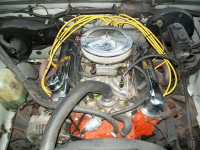

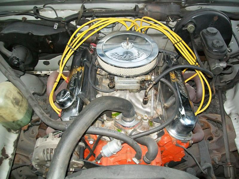

I also have edelbrock valve covers with 1 hole each. I just add my oil where the pcv valve is. My funnel fits right in the grommet, and the baffle is different than where the breather goes. In allows faster oil filling. Yours may be the same.
pic
The pcv valve allows for easy oil fill up, but the breather hole Takes oil very slowly and results in spillage
