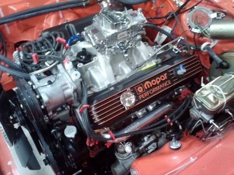

Biomedthechguy- I'm interested in this PVC and have seen it before. I too have MP valve covers on my engine with ZERO miles on the engine (soon will be road worthy) and look at picture attached. It has a PVC installed in the location. My question is about tuning it to the engine- So I gather to use a vacuum gauge to "tweek" it to my engine? What all is entailed?
Looking at their site it has different adapters- I'm not sure what options to purchase with the valve. I'm not at home right now but will be soon from my deployment and not at my computer to look at the article fully (I'm on my work computer :lol:. Thanks for any info and the article!

View attachment 676421 View attachment 676422
I don't think you'll need any adapter. I used one on the Pontiac 421 Tripower because I had to "lift" the PCV valve up some off of the valley pan where it goes on the 421.
On my 440, I just got a grommet that fit both the hole in the valve cover and the PCV valve shaft that goes into it.
I have to make the time to tune both of mine. The instructions are extremely detailed, and you can call or shoot an email to Gene or Matt and get the story.

Biomed- I don't know the size of the grommet that is in my valve cover right now, until I get home from deployment, but would the grommet need to be changed or is it good?
thanks!
Thank you for serving our country!
I really can't answer that question.
EDIT: It looks like the grommet you have will fit, but I can't be sure.
I went from the stock valve covers to the fabbed black aluminum ones, and I just brought my valve cover and PCV valve to the auto parts store and looked at their various grommets until I found one that fit the valve cover and PCV valve shaft.
