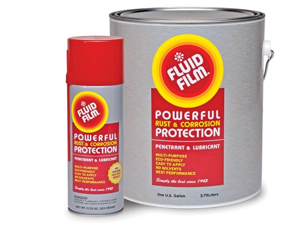

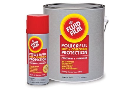

what, no fluid film??? this stuff is better than kroil IMHO
