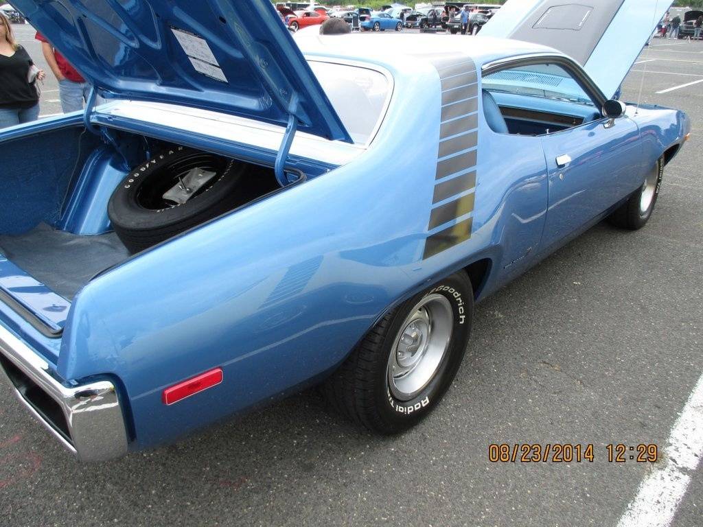

Early 72 Cars had the Pentastar on passenger fender just like all the years prior. I believe it stopped in Dec. 71 or Jan 72. Two friends with early cars have them, this Blue one is a Nov. 20 build. A May 72 build will not have one.

I do not see it in that pic, the angle cuts it off....I have heard the same that a friend of a friend has one....My duster was built in feb of 72 and no pentstar on the passenger side fender...I am not completely doubting you but actual pics would be beneficial. It may have been an early plant thing that got stopped mid stream....This is not the first debate over this issue either...Most will say you cannot be wrong either way in 72 but no way in 73...
You need to look closer after you open the picture up. If your using a computer you will see it. If your using a phone your wasting your time. I don't speak in friend of a friend, I speak in fact or else I wouldn't have answered this post. You would be wrong to put one on a 72 built after Dec. of 71. I'll contact my other buddy now with an SPD of 824 to post his will that make you believe?

I see it

Cool your horses a bit I am just talking things out here and what I have seen..btw I opened it on my Mac and I do not see it. Scratch that I pulled it up on my 27" comp and I do see it, thanks...it can be easily missed...
If you read my post I am not doubting you completely but I would like to see original cars with them, that's all....and a better pic of it would be great.
There was a lot of variations with plants Plymouth may have gotten them early versus a Dodge but this is a good topic to she'd some light....
The dust spec...lol....I see it now thanks....it would be interesting to know what month the change occurred...

Lol yea it is kinda hard to see

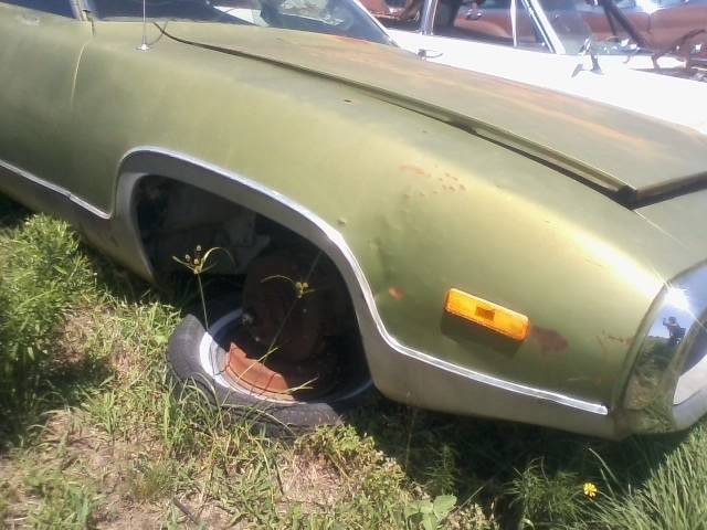

I may also have another original car that I know was a very early build as it had the cut outs for the go wing. This is a 72 sebring plus and it looks like it has one as well but could be rust too??? Can't see for sure. Unfortunately I didn't take better pics.
I may also have another original car that I know was a very early build as it had the cut outs for the go wing. This is a 72 sebring plus and it looks like it has one as well but could be rust too??? Can't see for sure but looks like it has one as well. Unfortunately I didn't take better pics.

I can see it as well. Thank you all for your help. I will not be putting it on my car.

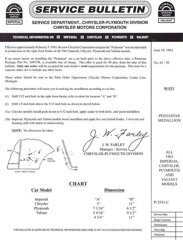

My understanding was they stopped in January of 72. So early production (Aug-Dec) would most likely have them, later would not. 63 was correct see below.
