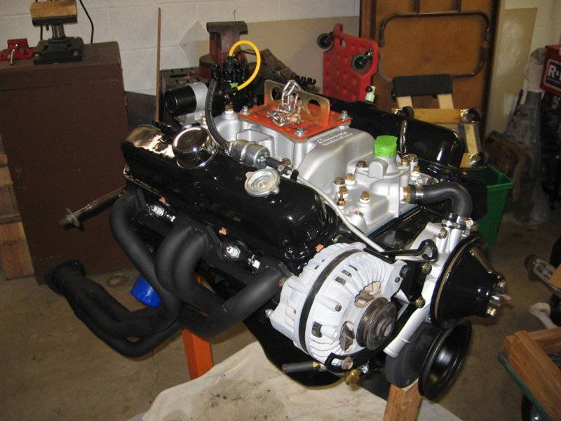

The Performer by Edelbrock,#2176 is of the small port design. It works well on the stock 318 heads.Used you can find them in the $125 up range. I picked mine up for 100 bucks.Works for me.
