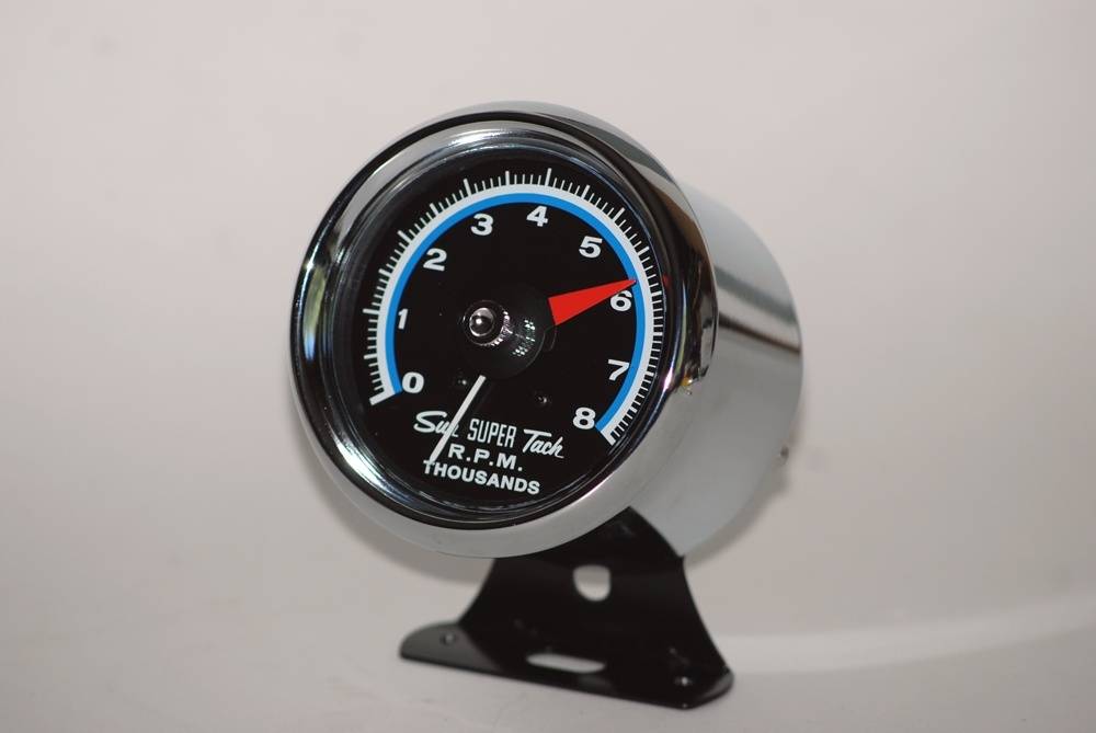

I think you may be able to get the sun super tach still as a reproduction,
but not certain on that, but anyway, here is one,

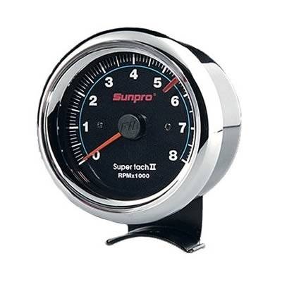

They still make them, and the new ones look similar... so you have a choice
Modern...

Sun was bought out by another company. They are called Sun Pro. They are just a cheap made tach, barley similar to the Sun Super II. They did come out with a reproduction of the old Sun Super II, but for some reason must have been pulled out of market , as I tried to get one, and all sources said they were no longer available.
I did finally find a real nice original Sun Super II with the chrome cup and no transmitter as the early ones had. Look on e-bay...................MO

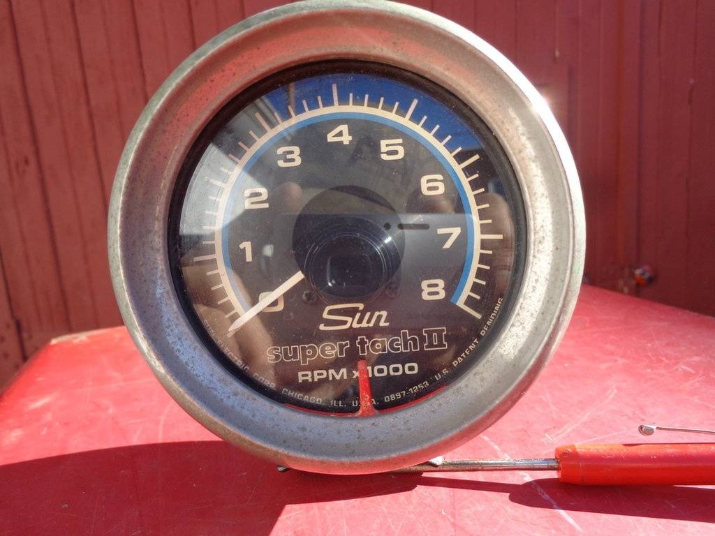

My Sun Super Tach II, model CP-7901, late 1977 early 1978. The Sun Super Tach II has four wires.
T= negative terminal of coil
B= ignition switch or accessory terminal of fuse box
L= dash light circuit
G= engine ground

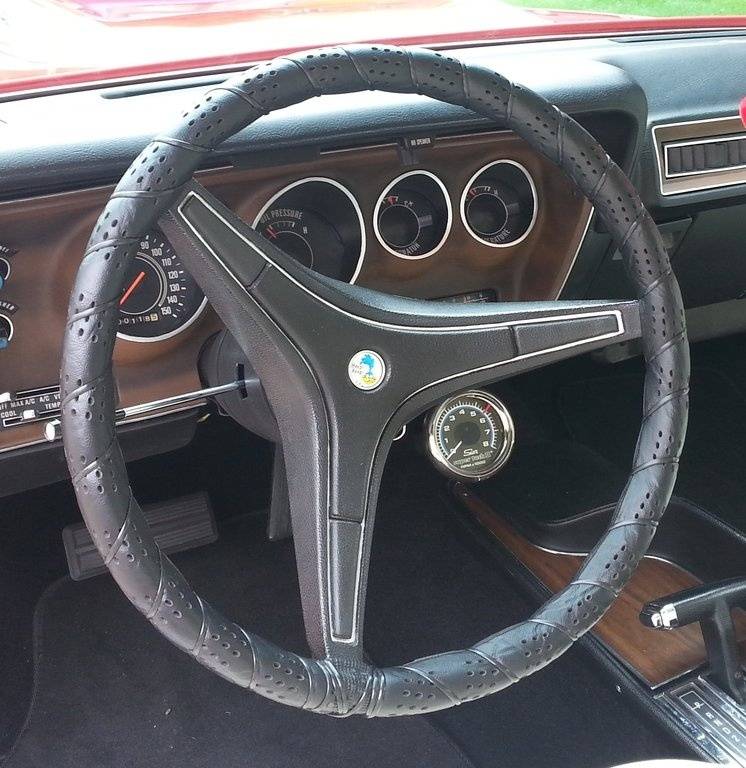

I put a Sun Tack in the dash of my old 70 charger.
As I recall it was not hard to do.
This is a pic of that dash that I held on to when I scrapped the car.

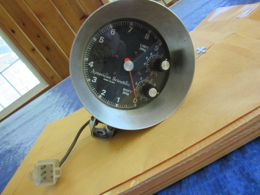

Here is one from back in a day I forgot. A friend gave it to me in the mid 70s. (I think).
