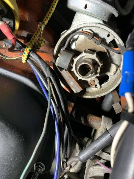

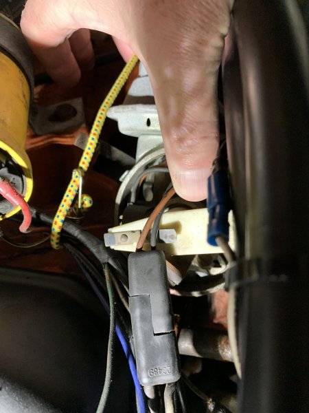

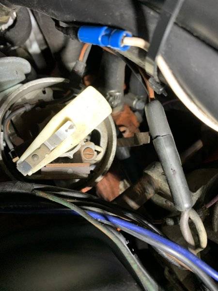

Hi all,
installing a Pertronix Igniter and Flamethrower coil in my ‘69 Super Bee this after. i don’t like to make assumptions, so I’m asking for your feedback.

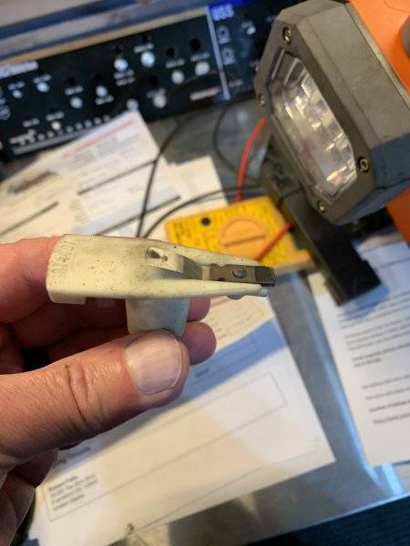

The car already has some sort of electronic ignition in it…it doesn’t look like a Pertronix. Can you help me ID this part? Looks like it uses a conventional rotor.
I have the following connection for the points/condenser wires out of the distributor with the current setup.(see pics)
I believe I should be able to cut this connector on the distributor side and connect to the red/black wires of the Igniter. Do you agree?
Thanks!
Bob
That is a factory Mopar electronic distributor. What model Pertronix kit are you using? You need the right kit and the right instructions.

It has a factory chrysler electronic ignition.
Yes that's the regular rotor.
Those are the magnetic pickup wires for the factory ignition.

The new ignition system will have nothing to do with those wires.
