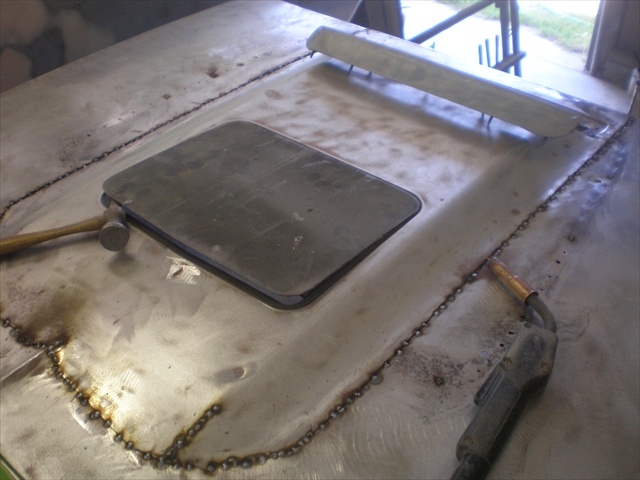

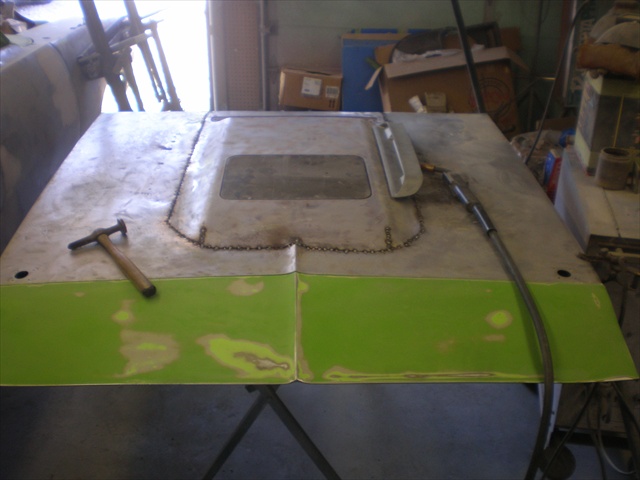

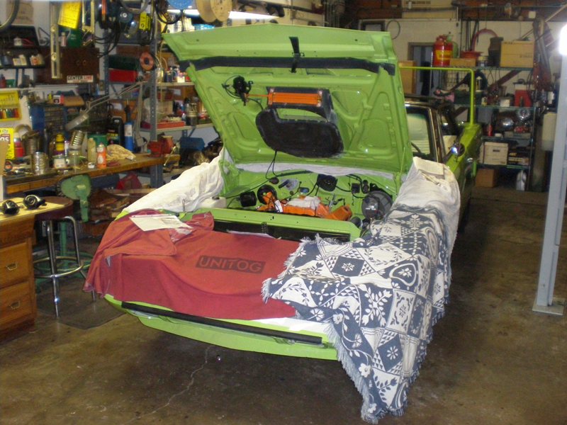

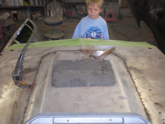

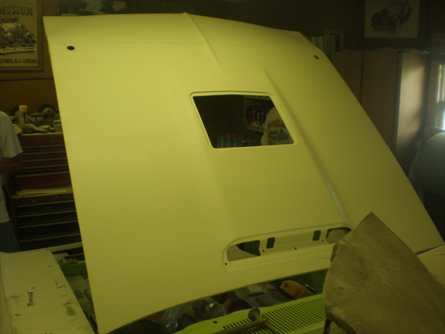

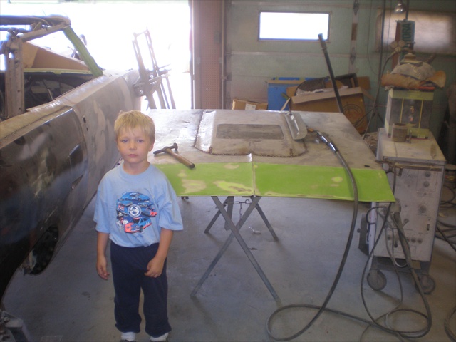

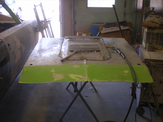

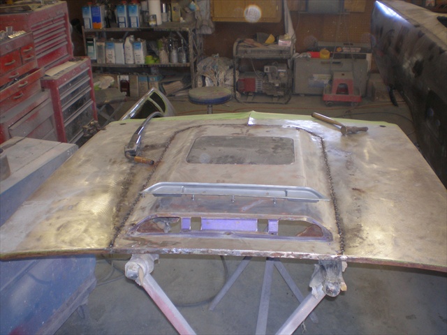

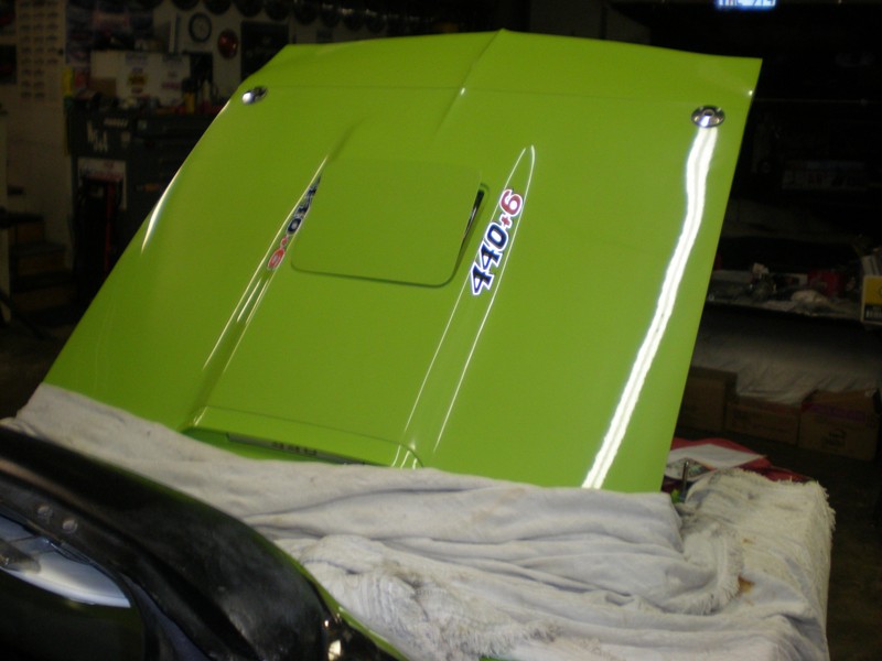

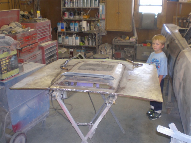

here is what I have to do to make my air grabber hood , We made it before they made these kits .
Wow, what a ton of work! Great stuff...I'm not a good body guy, si I hope I onlt have to drill a few holes, and cut the center of the hood out!
Mark
Mark

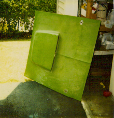

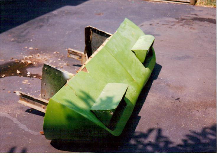

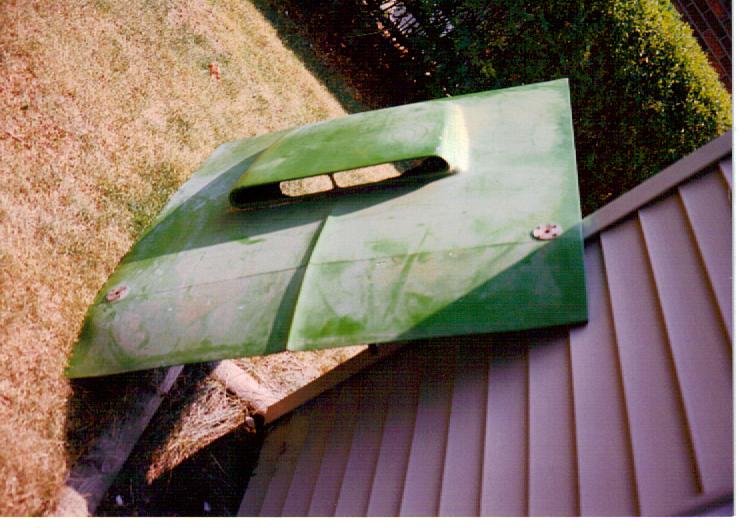

well my real superbird hood was butchered with an aweful sixpack scoope , they hacked up the center of the hood and just folded the excess metal under. It was all jagged and nasty. So this was my best idea to save the hood . I love it
Hey Stuart, GREAT save on the hood ! that Booger was nasty !, I can't believe someone did that to an original Superbird hood !

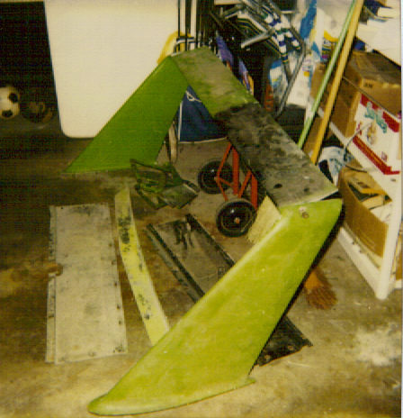

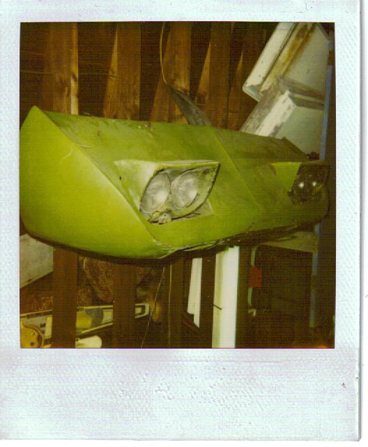

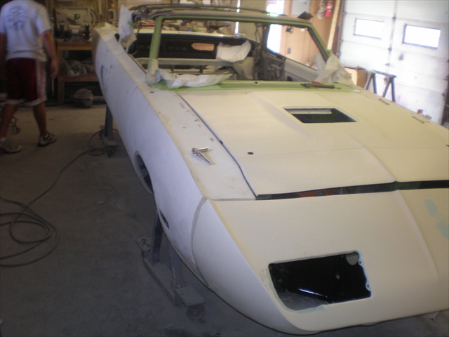

well the car was know to be like that since the mid 70's and them in 79 it was t boned and crushed , Back then they were just another used car . I am just luck the guy at the body shop saved all the good parts off it and stored them for 20 years . The nose hung in the rafters of his shop all that time .
Nice work on the hood! I like it! Question: on the spot welds, did you close up the entire welded area with spot welds until it was completely sealed with metal, or, did you use a filler between the welded in spot/tack welds?
What a feat, good job!
