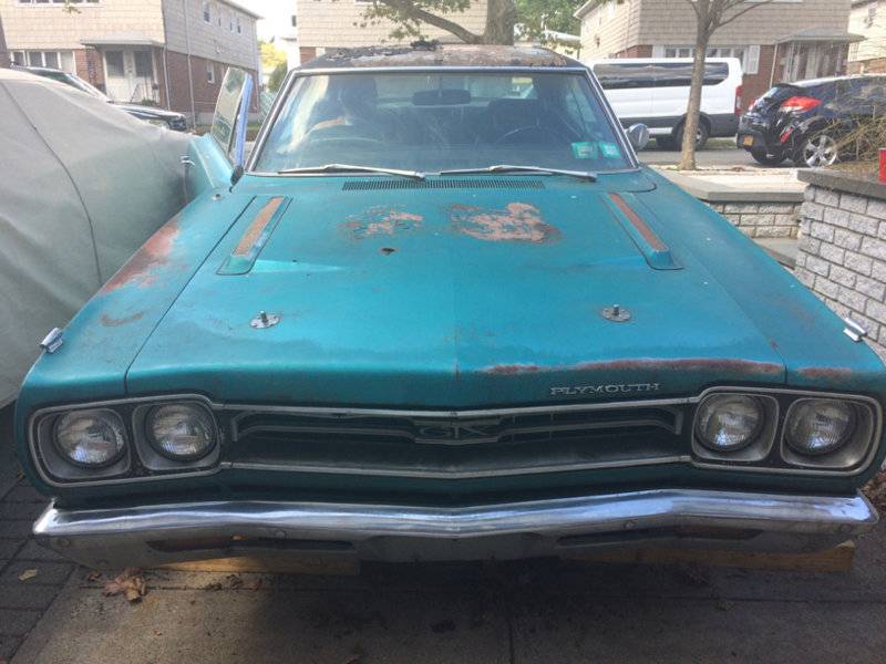

Picked up a 69 GTX - N96, Dana, 4 speed, super track pack, power windows, AM-FM
1968rt
11:26 PM
Jul 28, 2010
956
1,281
New York

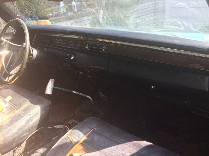

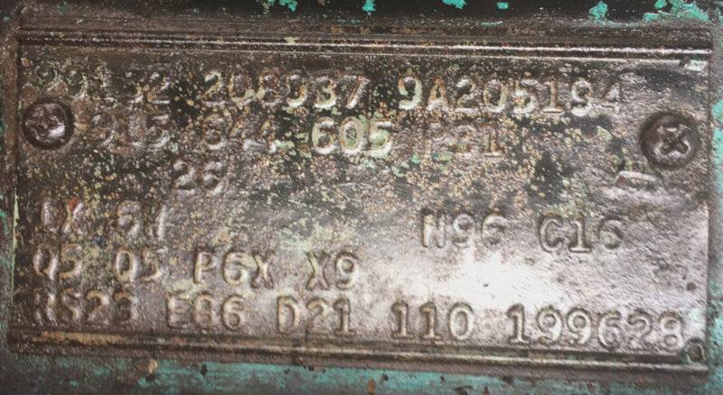

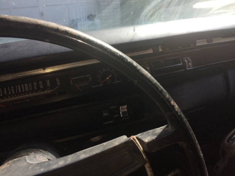

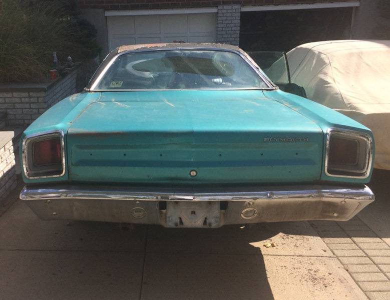

Picked up a 69 GTX. Has the usual rust. The front floor pans are trashed.Lower quarters and lower rear window have holes The rails are very good. Numbers matching 440, 4 speed, Dana Super track pack, power windows, AM FM, N96. Car is Q5 paint code...nice color. I got a great deal that I couldnt pass up. Can anyone help decoding the fender tag. Im not familiar with 69s. Thanks

Tried that decoder....not working right....looking for another
You start from the bottom up...Bottom of the FT and transfer those numbers to the bottom of the decoder and then the next line etc....
That is a sweet car! That tag format is throwing me a bit.....but will take a stab :-/
I'm thinking Q5 Q5 it shouldn't have a vinyl roof, but all paint in Q5 !
"26" is a 26 inch radiator
C16 is a console and P6X and X9 is Black front bucket interior and panel paint.
E86 and D21 is 440HP and 4 speed.
  • 6w should be a white longitudinal double stripe.
  • Fifth line up from the bottom are codes for which engine, trans and rear end. 915 - 440 hp, etc.
  • 9a205194 in upper right should match the vin on the dash, the radiator core support, and the trunk frame. Other numbers on top line are internal assy.line codes. Sorry, don't know the p31.
P31 is for power windows...
N96 is the Air Grabber fresh air induction.
you need a Lynch Rd tag/sequence decoder...
...or member @69Coronetrt
29 =Gate
152=Base
208837 = sequence number.
All are related to the production of the body in white.
9=1969 model year
A = Lynch Road Plant
205194 = VIN number
915 = engine assembly = B body 440-4bbl HP with four speed
644 = rear axle assembly = B body 9.75 Dana with 4:10 gears and SG (A34 package)
605 = B body four speed behind 440-4 and Hemi
P31 = power windows
26 = 26" radiator
(V)1X = black vinyl top
(V)6w = white side stripe
N96 = Air Grabber hood
C16 = console
Q5 = Top color (Roof) Turquoise
Q5 = Bottom color (lower part of the car) Turquoise
P6X = interior trim = Premium level, vinyl bucket seats, black
X9 = inner upper door frames painted black
RS23 = Belvedere line, GTX model, two door hard top
E86= sales code for 440-4 HP engine
D21 = sales code for four speed transmission
110 = scheduled production date of January 10, 1969 (may or may not be actual build date)
119628 = Vehicle Order Number (VON)
29 =Gate
152=Base
9=1969 model year
205194 = VIN number
P31 = power windows
26 = 26" radiator
C16 = console
