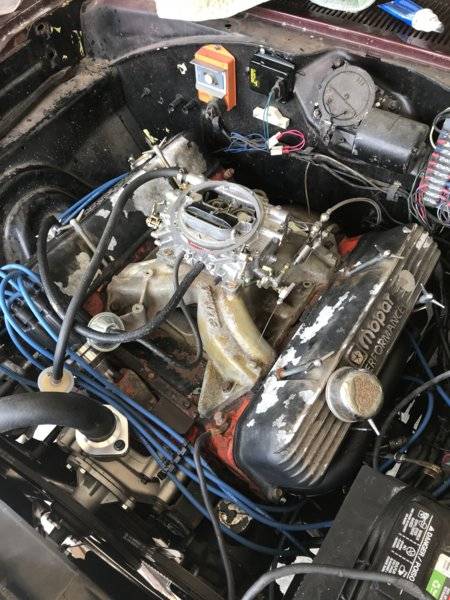

Sooo I’ve been working on the Charger and I got the 440 in.
I went with a Pertronix distributor and tested the electronic ignition system and found that I was getting no power to the Coil. When I unplugged the control unit connection I found a lot of oxidation. So I’m going to replace that and hopefully it’ll fire up. Any recommendations on a replacement unit for that orange box?
Pertronix ignitor2
