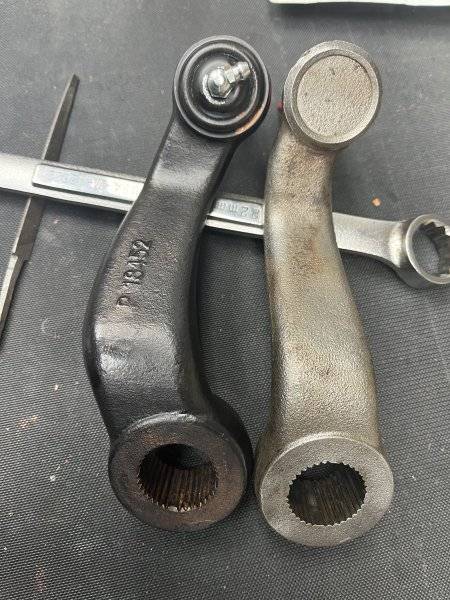

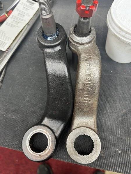

if this rare parts pitman is correct, why doesn't it line up when installed?
Return it !! Buy one from Mobile Parts on this site. You will get the right part and support member on this site.

I'd check what early b suggested. Get your steering wheel to turn the same amount of turns right and left. Make sure the shaft the pitman arm goes on is centered as well. See how it lines up with the steering link. You might have to shorten one tie rod and lengthen the other. Someone probably screwed up the tie rod lengths before you bought it. I went through this in my truck. The alignment tech said I have the wrong pitman arm and he couldn't align it. The steering wheel would turn 2 1/2 turns one way and 3 1/2 the other way and I had never noticed! Adjusting the tie rod lengths fixed the problem.
Thank you for your response. The whole reason all this started was my steering wheel was off center, so I was going to adjust tie rods to center it. Got a closer look and saw tie rods needed replaced. Removed old tie rods and then noticed Pitman was shot as well. Tried to install Pitman I bought, and it won't center to where it needs to be. As you know Pitman can only go on one way correctly. Once proper Pitman is installed and centered, I WILL give it a try. I will need alignment once complete. Thanks again!
