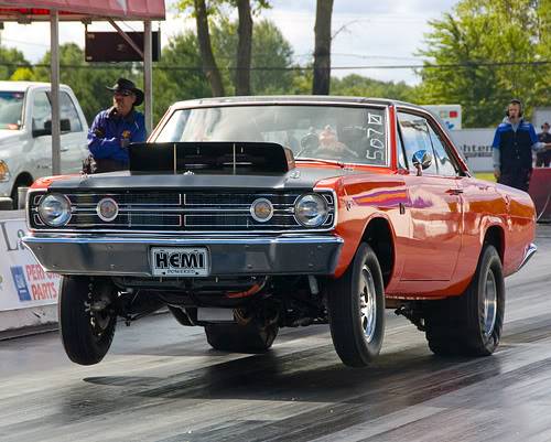

I run 4 down on the dart. I measure off the front of the damper and off the rear end yoke. I’ve tried it a few different angles and that’s what worked best on my car. They are all a bit different though. These pictures are with an all iron hemi with a 60lb cross ram, 2 carbs, and the biggest radiator I can fit. Definitely not ideal for weight transfer.
