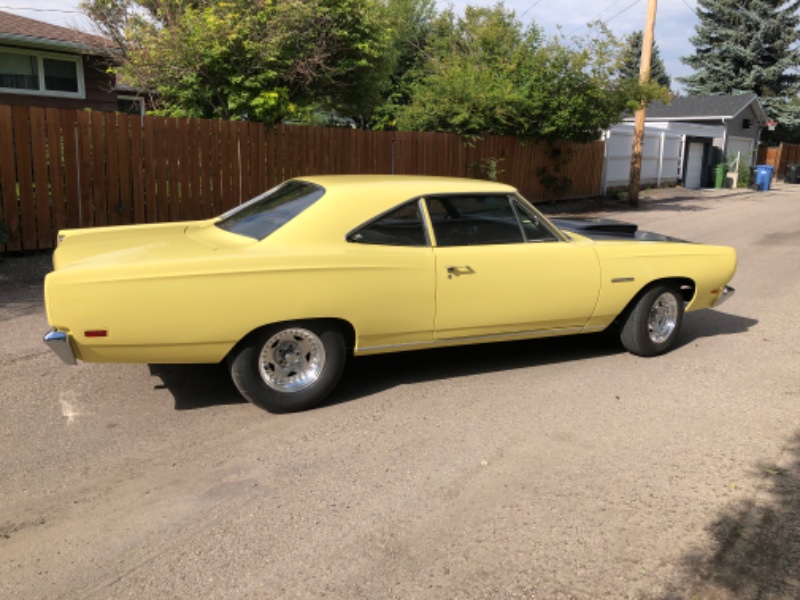

I'm using the 4 7/8 bs cl too. Fit great on my 69 rr, needs a small spacer on my 62. (65 8 3/4 rear?)

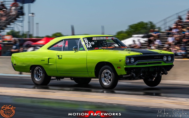

You’ll have to pry my M/T PBR’s out of my cold dead hands. Only thing I’ll run. On a coke-bottle body, 29.5x10.5s would fill the wheelwell nicely.

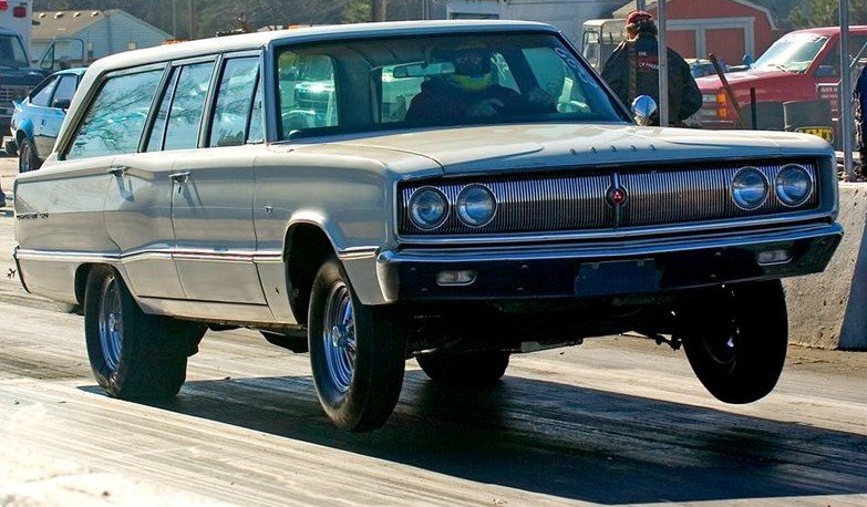

This was 9X30's on a 7" rim. Over 4000lbs, 4.10 gear, SS springs, and about 600 hp. Best "time-slip" pass, was 11.30 and 1.50 60ft.
I was warned to go slower or leave [lap-belt and no bar]. We re-jetted for the cold weather, left at higher rpm, and adjusted tire pressure. It went 10.89 on the scoreboard, but they wouldn't give me the time-slip...and told me to leave.
Wow, thats a cool ´67 Station Wagon!!! May I ask if you just run the SS Springs or do you have anything else like cal tracs, traction bars, pinion snubber? Thanks in advance!
Jan
Nothing, except the springs. One thing I did do, was put air-shocks on individual lines to preload as it worked best. Never more than 25lbs on either side.
