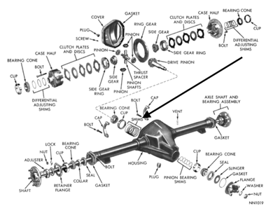

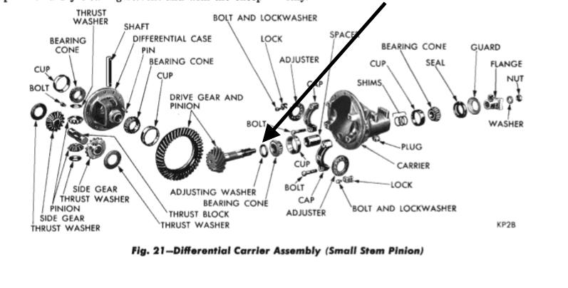

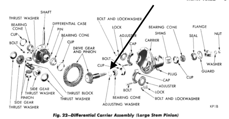

Ok, I just went & checked, 742 uses a shim between the gear & bearing cone.... Dana & 9 1/4 use shims between the cup & case...
741
742
9.25 & 9.75
