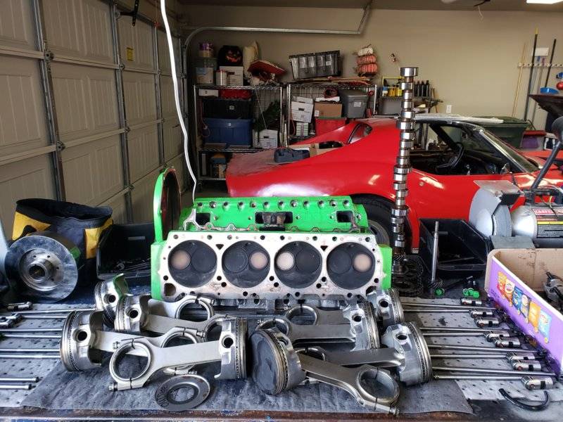

Ti wrist pins are becoming more popular due to now competitive prices. 40% in weight reduction. With same strength? BME is selling with their rods. I haven’t seen Ross offer as yet. But I'm seeing no downside? Has anyone tried? I was told Ti rods are rough on bearings. But pins? Why not?
Titanium rods, wrist pins and anything made from this metal is lighter and stronger but for many years, way expensive. I agree with Cojohnson1, why not! It's only money and speed costs money! :thumbsup:
Bob :moparsmiley:
A strong wrist pin is more important than a light one. Just like pushrods. Tread carefully and talk to someone like Diamond. My race motor pins are 157 grams with no ill effects. Total bobweight is 2222 grams (572").

I agree with you Doug and I spoke with Diamond for the piston specs and they agreed with my choice of pins. I don't have a total bob weight yet as the balance is being done, hopefully by the end of this week.
Bob :moparsmiley:
