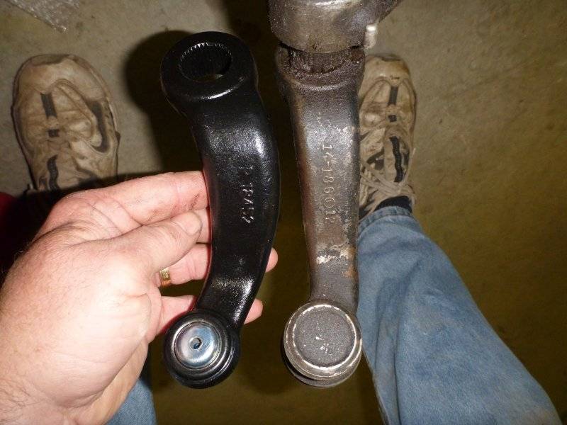

Here's my OE still on the box (or possibly a 70's CTC replacement) and my PST replacement arm I put on in 2017... both worked just fine.

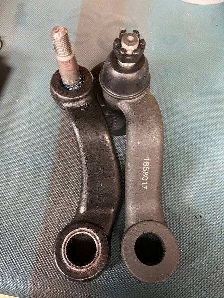

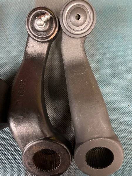

If you’re still trying to find the exact replacement pitman arm, I got one from classic industries , the one from PST would not work with what I have. PST is on the left, classic is on the right.
