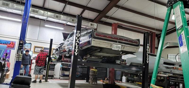

Have the alignment done. My car drove straight, didn't wander and the toe was off a little. Made a difference in the way it drives.

Nice car, I’m gonna after I get some other things done. Just got done with sniper system and tank and all the plumbing done. Having some weird electrical problem in the dash I have to figure out.
