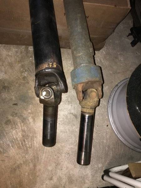

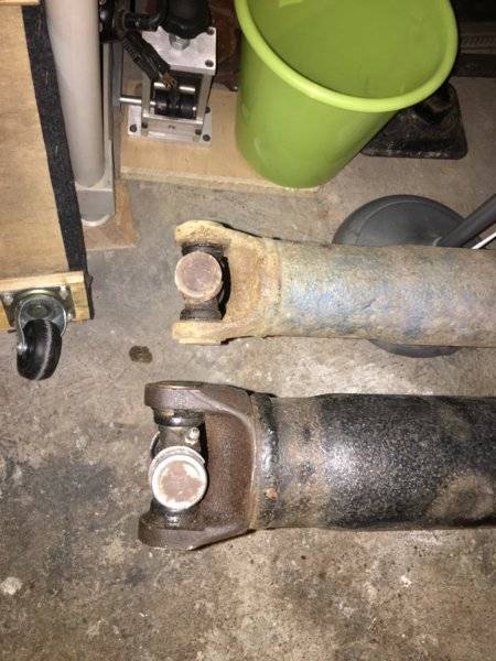

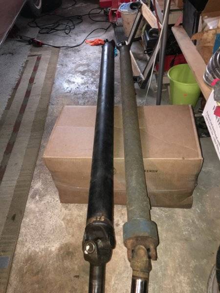

Hi thanks for all the responses... I didn’t do all my due diligence before swapping out the rears but all seems to have worked out. The new rear is square just double check. The new springs 20 inch from pin to center of eye bolt, originals are 21.5 to center. The original brackets are 3 1/4 the other brackets are 4 3/8. The original driveshaft is 63 1/8 yoke and all, the heavy duty is 62 1/2. The distance from tip of the gear at end of trans to where the u-joint bolts up is 54 3/4.

Hi AR, there is no movement at all. I’m pretty sure I have to shorten shaft either way, I’m trying to figure out if I need to go through the work of moving my rear back or I can leave it where it is and just cut the shaft to fit.
View attachment 587141 View attachment 587142 View attachment 587143
Thouht you were taking original 65 driveshaft. Neither of those shafts are original to a 65.
