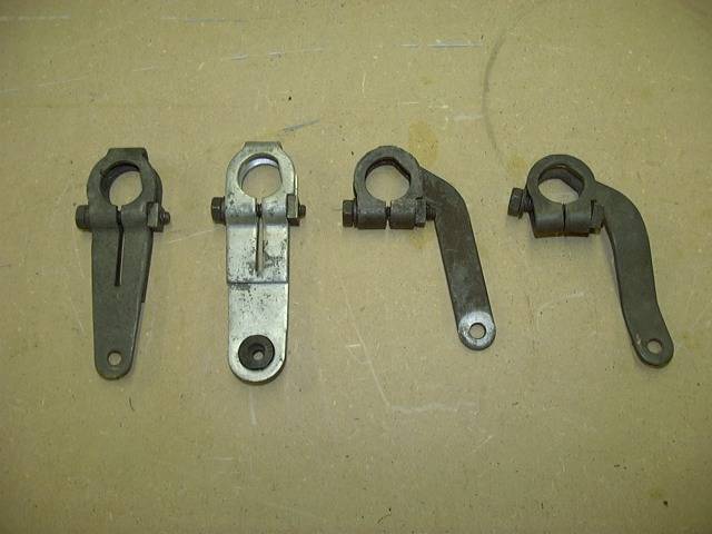

Is it the plate that mounts to the transmission? Mine is a floor shift, but here is the plate for reference.

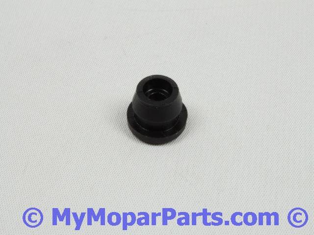

Crystal clear but not very helpful for the OP's dilemma. Part number is 3575333

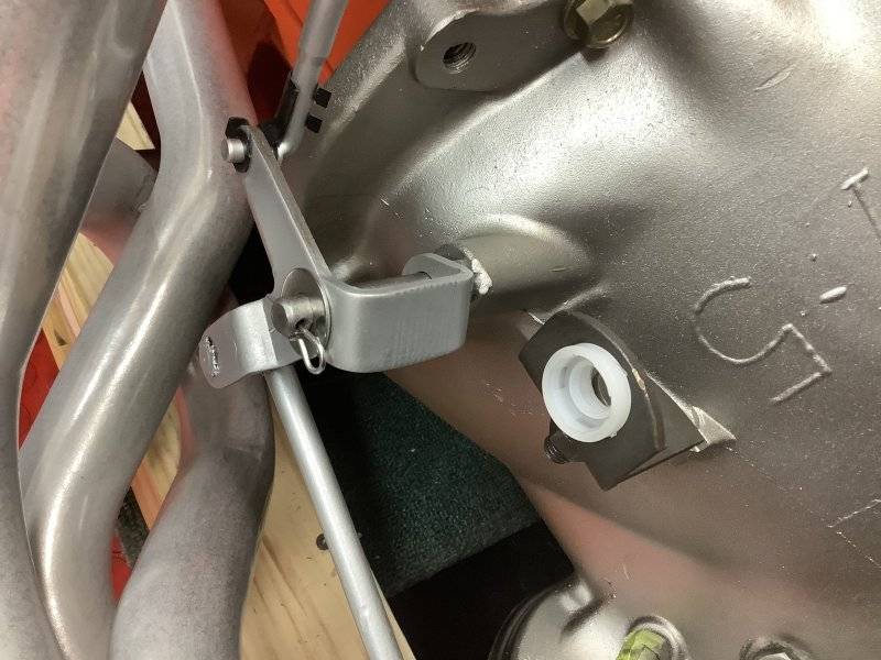

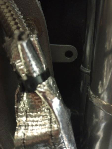

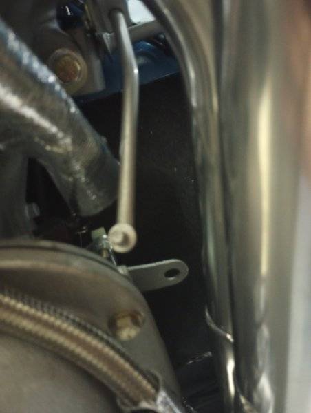

So I crawled under the car. Looks like the trans lever is not correct for a 69. I have another trans I'll see if it has the correct lever.
So I pulled the arms off a spare tranny. It has the right size hole for the linkage. I need to make sure it's the right length though.
Bolt it on and see if your shift quadrant matches up with the valve body detent's. You might have to adjust the linkage. I assume the rod that goes through the hole in the arm is drilled for a retaining pin.
The one on my ‘69 is straight. I may have a spare around here if you need it, let me know and I’ll try to find it.
