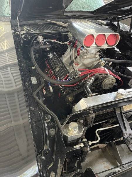

Please check my 383 build. Does it work together?
There IS no surprise your struggling. That intake is huge on a anemic engine, it has no port velocity.

I think we can agree you have a bad-a** car, especially given that it's a not a vehicle you would see every day over there. What I would do is embrace the "sleeper" mentality and fix the car up with a proper running combo that fits under the hood. Put the tunnel-ram setup on your workshop shelf.....(don't ever sell it lol), and tell anyone who asks enormous fish stories about how brutally wicked the car was when it was installed.

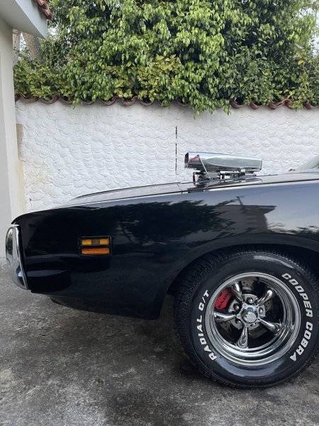

How about a pic of what’s sticking out of the hood now?

Got it, pic easy. Attached. Agreed, will go smaller TR or epoxy, 4000 converter and take it from there. I can always get low profile 2x4 intake later on.

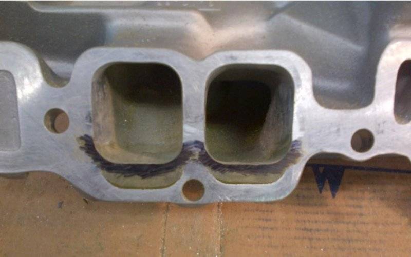

Your car has to get some attention over there. Thanks for the picture. This isn't a mopar intake, but a example of epoxy being used.
