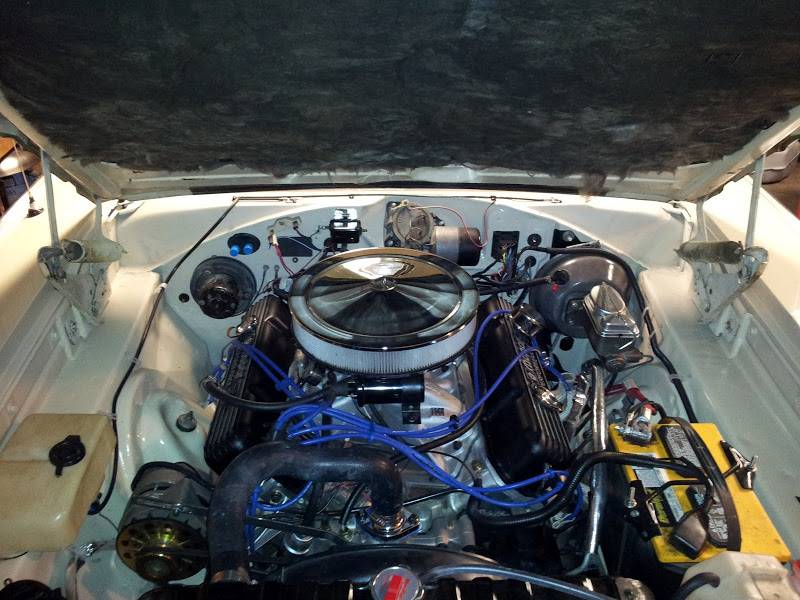

I'm running a edelbrock rpm intake with a holley 750 on my 440 in my 66 belvedere. I couldn't run the drop base because of where I wanted the coil and the kick down linkage was also in the way. I wanted the look of the unsilenced breather. I went down to my local auto parts store and they had a catalog with all of the different size filters. I found a filter that was a lot shorter that was the same diameter. Since the unsilenced breather top is larger the base the shorter filter dropped the lid. It's real close but the breather clears the hood. I've put about 2000 miles on it since finishing it. Fits great with the flat hood of the 66 bel. Here's a pic of when I was putting it all together. Only down side is I couldn't run the insulation pad under the hood. I just pop the hood a little after taking it on a run on a hot day.
