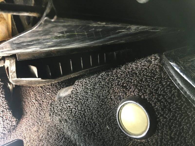

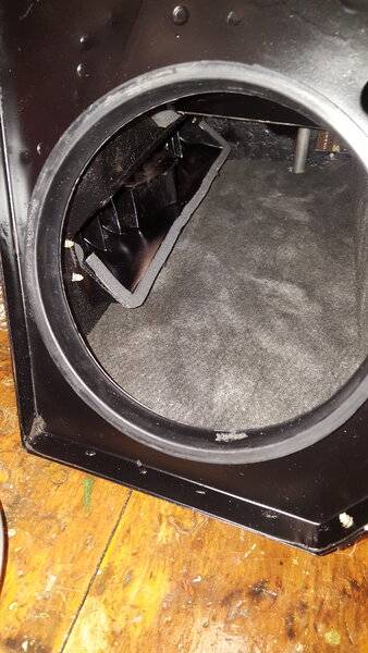

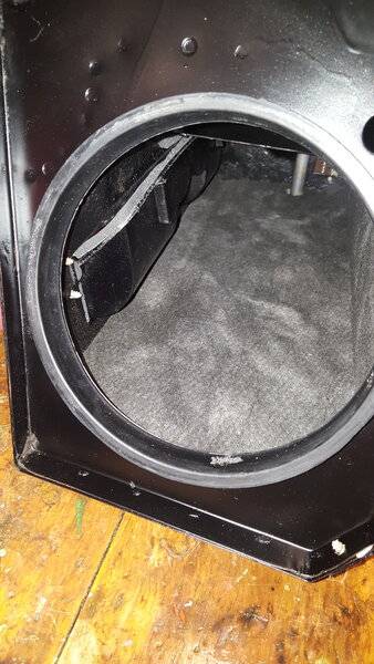

To clarify the front actuator, the door you can see, in is fresh air, first pic door open to incoming air, out is heat to your feet, second pic door is closed to incoming air forcing it through the heater core.
For defrost to work, this has to be out/closed as well.

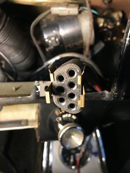

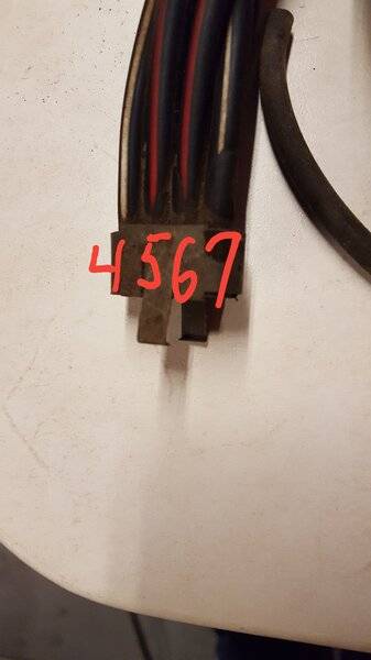

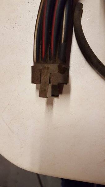

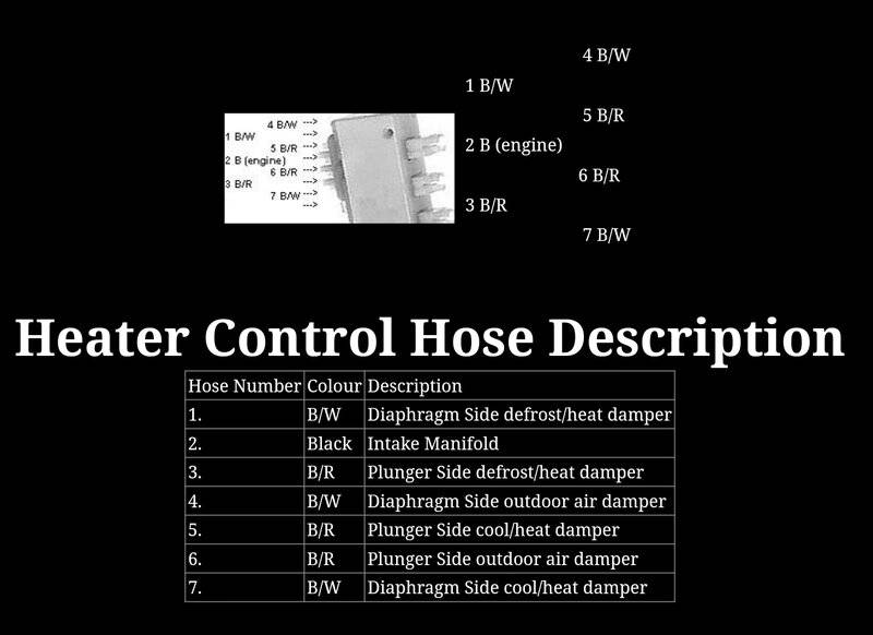

OK I am still in trouble here. I relied on this article (below) for the numbers on the connector ports and to know which motor they go to. Unfortunately now that I have it ALL BACK TOGETHER I noticed that the picture of the switch in the article is UPSIDE DOWN relative to how it sits in the car. What I need (idealy) is an indication on a picture like this of which hose goes to the diaphragm side and the plunger side of each vacuum motor. Having a mini nervous breakdown here after zero sleep
https://1962to1965mopar.ornocar.org/ml-62-65heaters.html

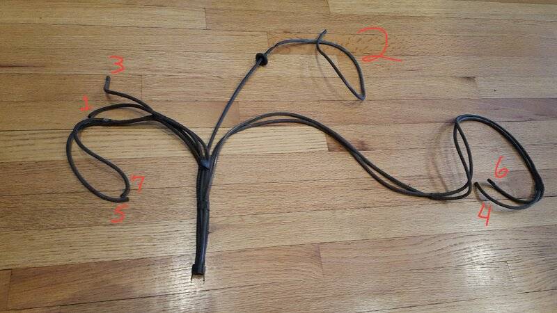

Yes that's my connector. You helped me identify the right names and functions of the three vac motors. I just can't tell from the sketch which one goes to each motor. I know that white stripe always goes on the diaphram side. I need a map from the rear view of the connector (like my picture) that shows where each hose goes to each motor.
I can pull a vacuum on it with switch hooked up. The doors open and close but not for proper function in each mode

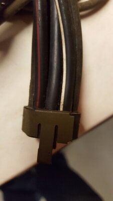

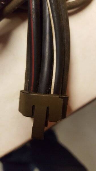

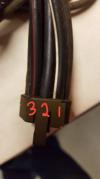

Isn't this the map?
1-3 are the 3, 4-7 are the 4.
Because I flipped it to take the pics, and the diagram shows the plug coming from the left, it would be:
If I use those labels and that map the doors do not operate properly. So far I can get the outside air inlet door to operate properly by hooking up 4 and 6.

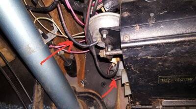

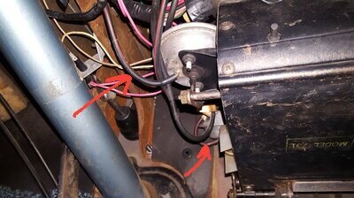

Are the plunger actions in each mode as described in that 62-65 Mopar article linked above correct? My outside air door moves quicky, the defroster plunger moves quickly, but the heat cool door seems to move the opposite of the description - even with the white stripe house on diaphragm side and red stripe hose on plunger side. I need someone to confirm that the plunger directions in that article are correct. Thanks.
Last question for tonight - Is this what the floor door should look like in "cool" mode? It only goes here in "cool". Thanks!!
My red stripe hoses are connected where the red arrows are in the pic, not sure if these are the plunger sides.

So the picture I posted of the lower door pointing straight out is correct for "cool" mode?
I think if you review the 62-65 article and look at the plunger position (in/out) definition for the forward most door (the door you can see) it is wrong. My door goes to the correct position but the plunger in/out definition is backwards. I spent 6 hours trying to figure out why the plunger was not behaving before I realized that the door itself was going to the correct position.
The description in the Cool/Heat damper section is correct.
The "HEAT" and "COOL" sections have the in/out reversed.
