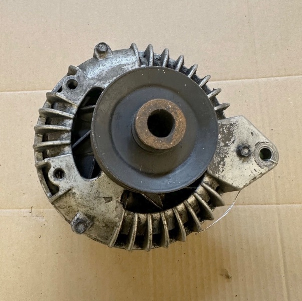

Please help ID this alternator

I keep reading round back, square back, single pole, etc...
I just need to know: if I want to find an alternator that puts out a bit more amperage......WHICH type am I looking for?
Or this aftermarket and already generating more than OEM?
I'm guessing a Dodge/Chrysler fit with a spot on the back for one wire and a pulley for two belts.
But it sounds like it's more complicated than that, for some reason. Lol
This is currently (no pun intended) in my 1969 Charger with no A/C (installing aftermarket soon).

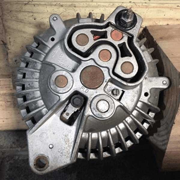

Round back, single field, with a catch-all dual pulley. Can be used on most '60's Mopars. This is what you will get from rebuilders through auto parts stores. It is almost impossible to get a single pulley on them anymore. Likely about 60 amps.
Just that the one you have is a correct alternator for the year, but got the wrong brush installed… and I’m showing the correct brush and how it looks installed.
The one installed there is from a double field alt. Does it work? Yes, but…
Aside of course the double pulley… being no A/C should be single pulley, and all those years got a larger diameter pulleys. They become smaller on lates 70 earliers 80s (the one your unit actually gets) to get more juice from them at idle speed (aside some other mods)
Gotcha. It seems to work. Maybe a good idea that I'm looking to change it, then. I can't seem to find a verified match online. My local auto parts store seems even worse. Lol
I'll have to do a few purchases and returns to get right, I suppose.

Factory used these 4 setups (despiting pulleys and outputs)
Up to 69… roundback single field
70-71… roundback dual field
73~80s… squareback dual field
80s~<… squareback dual field revised version
The last one is really similar and looks the same than earliers by an untrained eye but is a bit wider and bulky. They can get some fitment and alignment issues depending on engine and accesories
The other ones interchange perfectly.
You can get a dual field (round or squareback ) and ground one of the brushes to convert it into a single field
PowerMaster offers roundback 95 amps alt (60 at iddle) though. And the squareback they show on catalog is the revised version (or used to offer).
Can’t recall if TuffStuff offers High output roundbacks. I know they offer stock at least (or used to offer).

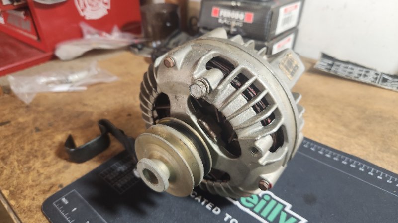

I run a chromed squareback I won as a door prize in my 66
it gives me a little more output
I just grounded the second field terminal
Awesome, thanks! Is there a preferred spot to ground the second field, or just wherever is closest?
If you get a dual field unit, you can wire one of the fields wherever around.
But you can also replace the isolation washer down the screw with a metallic one. That will also ground the brush and is cleaner. If you proceed with that is adviced to clip off the brush prong to save from wire it by mistake with the signal coming from the mech regulator, which is positive and if you wire it there will short out as soon put the key in RUN.
If you get a roundback dual field with the provision for the grounded brush, you could also get the correct brush for single field install it and remove the one on the opposite side.
