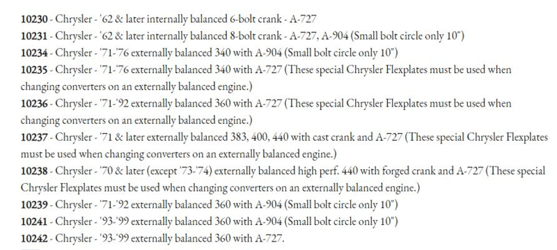

With the "proper" B&M flexplate you can.Did a 66 Charger with a 74 360 and 74 904. B&M makes 2 for the small block. The one you need for external balance will have a large notch in it. Summit Racing B&M # 10239

I don't want to add to the confusion, but I went through a lot of research to get the correct combination for my 360 with a 727.
Have a look at the information below...it may help out somewhat.
B&M Flexplate part numbers.....

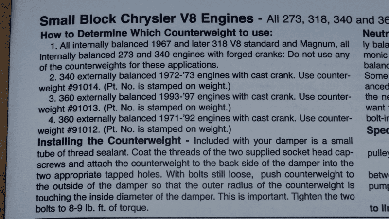

I used a weighted B&M
with a PowerForce Harmonic Dampener
There is a lot of information out there, but you have to be careful with the combinations.

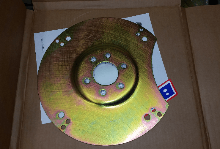

If the 360 B&M Flexplate has holes that fit you 904 converter and clears the starter nose you are good to go. The cut out takes the place of the 360 weights. The cut out is 180 degrees different from the factory 360 balance weights. Thus it's balanced without any extra converter weight. Engine balance isn't affected by the type of neutral balance converter.

As others stated above, it is an either/or for the converter. Either you need a weighted converter for the 360 or you need a "weighted" or non neutral flexplate, as pictured above in post #5.

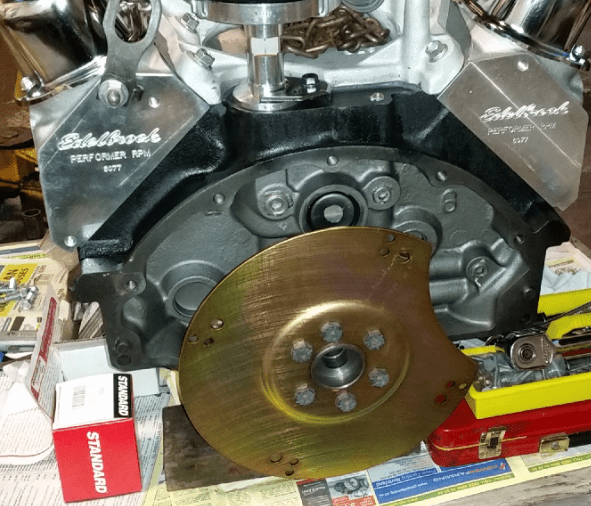

The B&M flexplate takes care of the balance issue, the pilot hub diameter is tough to say, some tech books say it changed in 64 so 65 should be good.. Other tech info shows the change in 67... I know on 727's & 904's the input shaft changed in 67 but I want to say the crankshaft/convertor pilot change was 64.... Worse case you have a spacer machined... The early T/C pilot is 1.55" the late pilot is 1.81" so you could easily use a spacer...
Only way to know for sure is to take it apart....
The other way is to use a 360/904 convertor but since the input shaft changed in 67 you would need to change that too... Do it the easy way, use the B&M flexplate & if there's a time factor just have the 1.55" I/D 1.81" O/D spacer available when you tear it down...
Could you please show me where this spacer would go? Or maybe explain?

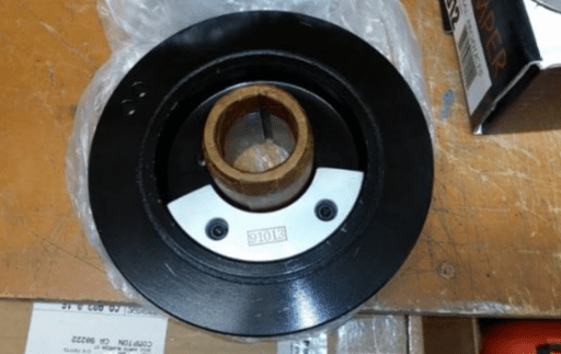

It is actually a bushing that goes over the torque converter "snout" or better known as the crankshaft register.Thus taking up the space between the crank and the smaller snout of the early 904 converter to the larger diameter 360 crank.
This is shown in post #15
